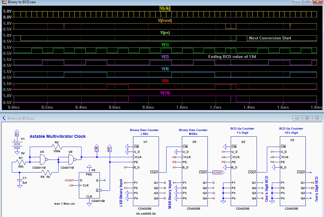

Hi, I am making a 32 bit binary calculator. With that I would like to display the answer on a few 7-segment displays. I can find schematics for such a converter but it requirs the sn74185a, which is badly availible. So do you have a alternitive ic or a schematic with logic gates? I don't want to use a FPGA because I would like to build the calculator using gates or simple ic's.

Below is a Binary to BCD converter using binary down-counters and BCD up-counters, discussed here.
The clock can be one available in the calculator.
How many digits do you want to display? It requires about 2 counters per digit.

So, just how long is it going to take to convert a 32-bit value (the width specified by the TS) from binary to bcd using this approach?

Depends upon how many digits he wants to display. :D
But you have a good point. It could get quite long for anything above 7 digits, even using high speed 74HC counters.
Above that you probably want to go with a ROM approach, if the TS doesn't want to use any microprocessors.

Even seven digits of output is probably getting pretty long. It's unlikely that the conversion clock is going at much over 10 MHz (especially if this is a breadboarded implementation during development) and 7 digits would let you go up to just under 10,000,000, so that would take up to a second for each conversion. Depending on the application, that may or may not be acceptable. But since it's a calculator, I know I would want a calculator that took a second to display every value that was punched in or each result (to say nothing of up to two to three minutes for values that were up against the limits).
Doing it with logic gates isn't a good idea. One four bit converter will take around 18 gates. Do you realize that if you go with something like 74185, you'll require dozens of them?
A lookup table is probably your best option.
TS says 32 bit binary. That's just 10 decimal digits, so I think ten 74185.
