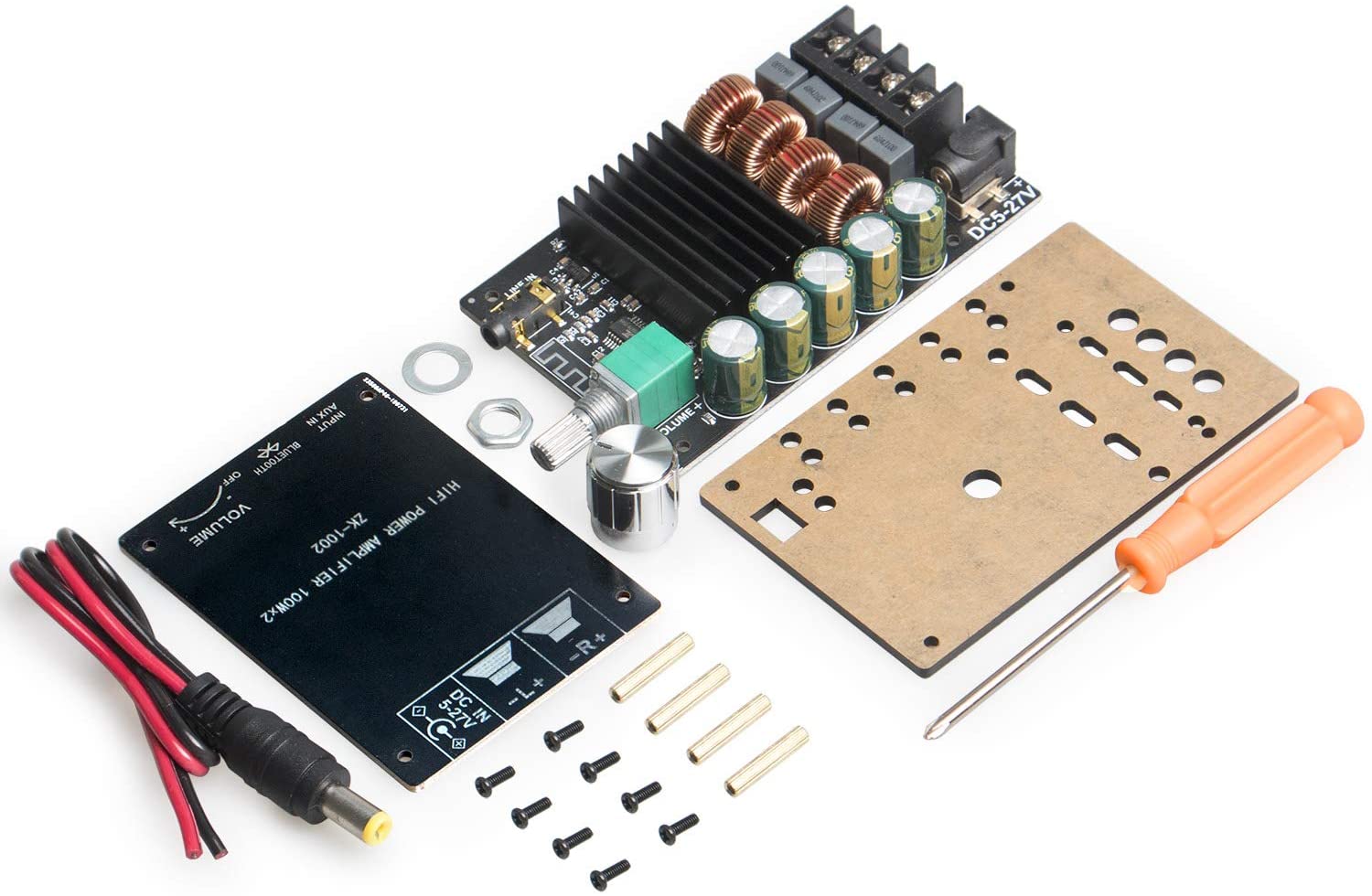

A single TPA3116D2 chip is 50W into 4ohm @ 21V, two bridged is 100W but THD is 10% (horrible). its 0.1% at 25W (50W bridged). Thats continuous output so average not peak, [ V^2/R = (21*.7)^2/4 = 50W ] but realistically you wouldn't want to run it above 25W if you want to listen to it. Looking at the datasheet and the suppliers pictures on Amazon the heatsinking is marginal, barely good enough for continuous output and badly compromised airflow due to row of capacitors blocking flow at one end. The 24v/2A from the supplier's blurb is running the board at 2 x 25W a channel which is where TI recommend it for general use at <1% THD.
If you really want good sound at 200W, look elsewhere....
BTW 200W into 4ohm speakers is 16A average... thats about 30min on your proposed battery pack...

Interesting... that board appears to be the suppliers version of the TI reference board in the datasheet, but the boxed version, and that shown on the OP's link with the row of caps down the side and larger toroidal filter inductors is different, but probably still only the one chip. I was being generous and assuming they'd used two chips, bridged per channel...
Anyway, that power input connector will melt at more than 5A or so...

Umm, not quite...
The top pic is the same amp as in my post #30, but the bottom pic is a different board with smd inductors rather than wound toroids, and no row of bulk caps along one side. That lower board is, mostly, being correctly marketed as 2 x 50W.

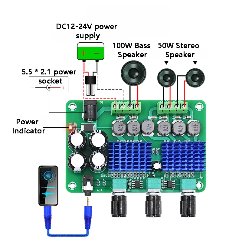

There are several examples of similar boards with 2 devices, e.g. this one, that use 1 chip for subwoofer @100W and 1 for L & R @ 50W
https://ae01.alicdn.com/kf/H9498251b05f14fd393db2407f991749c9.jpg
I'm fairly sure, judging by the number of 220u bulk caps that the OP's K1002 board has 2 chips, each providing a 100W channel. That said, the power connector isn't up to the job of driving 200W - it really needs a screw terminal like the above.

Hi Irving, you are correct. The amplifier has two TPA3116 ICs.
A seller on ebay is trying to cheat with the wrong photo.
All the Chinese places wrongly say 100W per channel into 4 ohms with a 24V supply.
Texas Instruments correctly says into 2 ohm speakers.

3) $5.00 TPA3116 with good heat sinks. For the money not much worry. Bigger aluminum enclosure with fans and connectors.
While the data sheet runs them at 32V they should do alright on 12V like 50W each but gets better with a fan.
