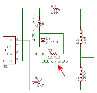

Since I am going right to a proto board and not a bread board, does this mean that I should be using a 91K resistor as apposed to a 1.2M?

Let's see - from memory, R1 controls the ON time, R2 controls the OFF time.
Do you have an O-scope? That'll help a lot.
Basically, you want to turn the MOSFET on long enough so that the 220uH inductor saturates, but not so long that Vgs rises appreciably, or the power dissipation in the MOSFET will become excessive and it'll get hot.
Then you want the MOSFET off long enough so that the caps recharge pretty close to full. If the MOSFET starts getting warm, you can increase the OFF time by increasing R2.
On my proto, I used 3.3k for R1 and 91k for R2. Your mileage may vary, due to the use of somewhat similar, yet different toroids. The AL value is close, but how quickly they will saturate depends somewhat on how you've wound them (evenly-spaced windings and taped toroids helps to delay the onset of saturation). If you scrunch the windings together on one side, you kill the Q of the inductor, and it will saturate much more quickly than if the windings are spread evenly.
Note that the point at which the inductor will saturate changes depending on the battery load, which I found interesting. Some folks use an NTC thermistor thermally connected to the MOSFET tab to control the on-time, which does work; as the resistor heats up, the ON-time decreases, which lets the MOSFET cool down.
[eta]
The original author used a physically larger inductor that was more resistant to saturation. These smaller inductors saturate more quickly, but the PRT (pulse repetition time) is much less. You'll still get a big voltage spike out of it.
iONic
Thus the MOSFET saturation is controlled, to some extent by the R2. Would a 50K in series with a 100K Trim make a good method for tweaking? I take it we do want saturation, but not continous, yes?
Any special tape to use on the inductors...??
The termister is taking the place of R1 or R2, or neither. Or perhaps as input to a comparator to turn off the 555?
The circuit I am using now does saturate enough for the MOSFET to get hot. I have a 555 PWM fan turning on and off to keep the temp stable. Sounds like this is not the best way to solve the problem.

OK, good.
No. R1 controls the ON time, R2 controls the OFF time.
Well, that would work. Trimpots have a limited life as far as the number of adjustments go. Better to tweak R1 so that the inductor just starts going into saturation (Vds starts increasing sharply just before the MOSFET turns off, indicating saturation.)
You want to get the inductor saturated. You'll see the "knee" when it hits saturation; Vds will rise sharply. A layer of tape will help to soften the knee.
You could use masking tape. I use a yellow polyester tape that's very thin, tough, high insulation value, and resistant to heat. 3M56 and Permacel P256 are examples.
The NTC thermistor is taking the place of R1 or R2, or neither. Or perhaps as input to a comparator to turn off the 555?
R1, as R1 controls the MOSFET ON-time. You'd need to start off with a thermistor that measures a bit too high at room temp; as the MOSFET heats up, the resistance decreases, so the ON-time decreases.
It's one way, but arguably not the best way.
When the inductor saturates, it does no good to keep running yet more current through it; it's not going to result in a higher-intensity pulse once the MOSFET cuts off.
I was thinking that it would allow for exact tweaking prior to fixed values.
I think I'll forgo this option, It would delay he completion. It's a bit sketchy for me to figure out.
Is the current spike in any way proportional to the batter size?
When the inductor saturates, it does no good to keep running yet more current through it; it's not going to result in a higher-intensity pulse once the MOSFET cuts off.[/QUOTE]
I am assuming it does still get a high-intensity pulse as the inductor is still singing...
