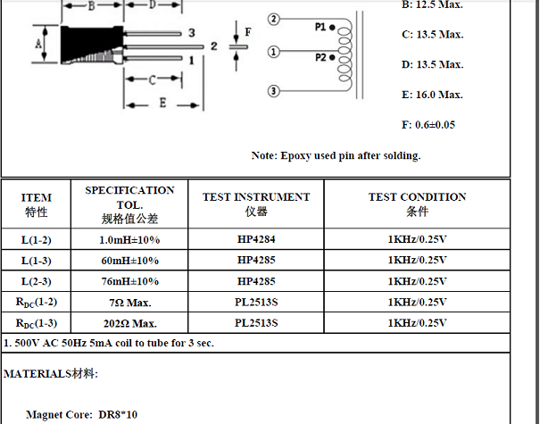

What is the turn ratio of this component (1-2:2-3)? Is it 8.7? - 1/76 = (1/n)^2
A Thread Starter airplane100000 Joined Aug 2, 2016 73 Sep 7, 2016 #1 What is the turn ratio of this component (1-2:2-3)? Is it 8.7? - 1/76 = (1/n)^2
AlbertHall Joined Jun 4, 2014 12,663 Sep 7, 2016 #2 That will be a reasonably close approximation. Note that the inductances have a 10% tolerance.
A Thread Starter airplane100000 Joined Aug 2, 2016 73 Sep 7, 2016 #4 Dodgydave said: The resistance ratios are 1:28 roughly.... Click to expand... Yes... So which is it?
AlbertHall Joined Jun 4, 2014 12,663 Sep 7, 2016 #5 I would expect the inductance ratios to be the better estimate. The resistances depend on the wire diameter used whereas the inductance doesn't.

Dodgydave Joined Jun 22, 2012 11,395 Sep 8, 2016 #6 Well i would input a low voltage ac into pins 2-3 and measure it on 1-2 to see the difference in ratios.
A Thread Starter airplane100000 Joined Aug 2, 2016 73 Sep 9, 2016 #7 Dodgydave said: Well i would input a low voltage ac into pins 2-3 and measure it on 1-2 to see the difference in ratios. Click to expand... Thanks... You wanna buy it and send it to me?
