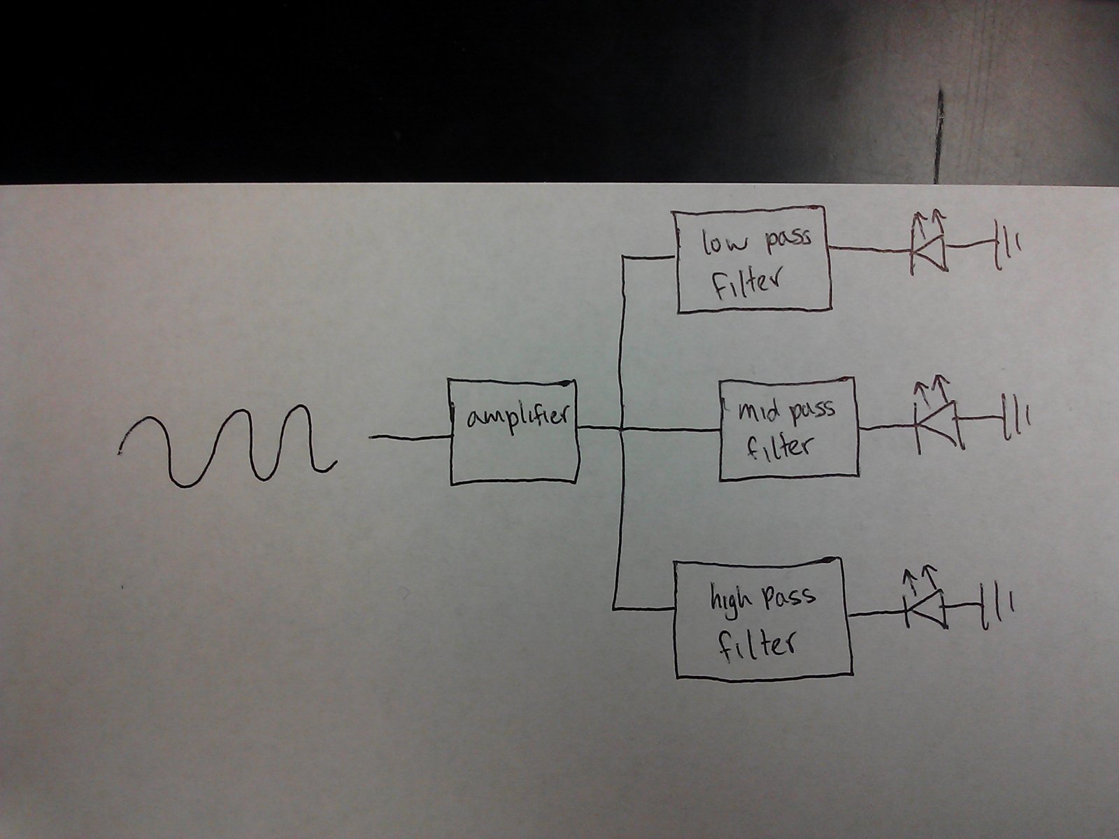

    Here is what our general design is(we think is) looks like:
    [​IMG]
    and here is our amplifier:
    http://tinypic.com/r/260ba6q/5
    basically I think we need to figure out the filters
  8. stollvj42
    Thread Starter New Member
    Dec 4, 2013
    4
    0
    dont know if that first one worked
    [​IMG]

    The block diagram is not bad, but it has 3 problems.
    Problem 1.
    MikeML mentioned "detector" circuit that will convert AC to dc. You need it to power the LED.
    Problem 2.
    Your LED are connected backwards.
    Problem 3.
    I expect your LED to have resistors in series. Why? General use LED have current rating of about 20-24 mA, this is the max. You don't want this max. You want something about 16 mA. So you need a resistor in series with LED to reduce the current to 16 mA. It might be a good idea to measure the current before you hook up LED, to see what it is, just in case.
