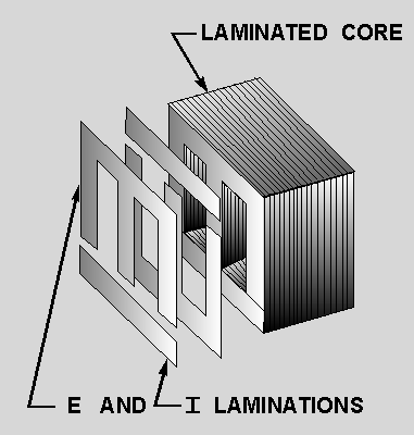

How did you manage to see that it is a ferrite core transformer?
I didn't. All I can see is the photo you posted.
I see enameled copper wire wrapped around a circular core with a square cross-section wrapped in white plastic. This is known as a toroid.
For a transformer to work efficiently it has to have a ferro-magnetic core. The most common types of transformer core construction are iron laminates or ferrite material.
Here is what E-I laminated core would look like:
Here is what a bare ferrite core would look like:
