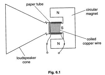

In order to understand how an audio amplifier works let us begin by examining how a loudspeaker works.
A loudspeaker is basically a paper cone with a coil of wire called the voice coil. The coil is surrounded by a very powerful magnet.
When we pass a current through the coil, the coil moves out, pushing the cone with it. When we pass a current through the coil in the opposite direction, the coil moves in, pulling the cone with it. When we make the current oscillate back and forth, the coil and cone will do the same producing an acoustic wave which is what we hear as sound.
The oscillating current through the coil can be appropriately be described as an alternating current.
(Don't bother to call it an alternating DC current because that would be oxymoronic.)

It's AC, you can't have "alternating DC" as that's a contradiction in terms, like Mr chips's post with the diagram of the speaker coil, to reproduce the original sound, the coil has to go "in and out," so the only way it can achieve this is with an AC signal.
