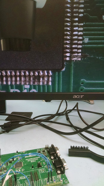

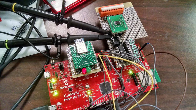

16,474
That's just a connector standard like many others. It nice because it uses standard vector-board pin/socket spacing. I've used it to make DIY plugin controller interfaces on PIC dev-boards with the mikroBUS connector.
Encoder signal buffer to a motor control system PIC32MKMC. https://www.microchip.com/wwwproducts/en/PIC32MK1024MCF100
The original dev-board pic32MKGP processor was replaced at a SMD rework station.
Bluetooth module adapter, analog I/O adapter for RIOT OS development PIC32MZEF. http://www.microchip.com/design-centers/32-bit/pic-32-bit-mcus/pic32mz-ef-family
