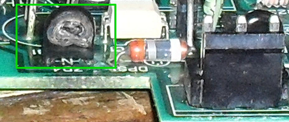

I burnt out a component on the PCB of my 1980's Japanese pinball machine (known as a pachinko machine) and was wondering if anyone can give me some info on it ... (see pic)
its a 24 volt AC system and the component markings are:
470K 411(?) where (?) is either a 9 or a symbol
a). Tell me what it is and what its ratings specs etc. are?
(I think it's a Zener Diode as the PCB has ZD3 marked below it)
b). Where can I get a replacement
c). can I substitue another component for it.
thanks folks

Considering the legend on the pcb, I would guess it's a zener diode, however the 470k marking is puzzling. It's also an odd shape for a zener or a resistor.

I agree with tracecom it doesn't look like a zener, it looks more like a capacitor.
So could you need a new one simply because the wrong component has been inserted at some time past?
Some detective work may be needed to find a circuit.
Make and model numbers etc of board, machine and so forth please.

The markings on the device suggest MOV while the markings on the board suggest TVS (back to back zeners). Either is possible in the same location so the board may have been designed for a TVS then populated with an MOV.

The symbol is not the customary one for a VDR or MOV, Teccor use this symbol for their Sidactor SCR type suppresion devices.

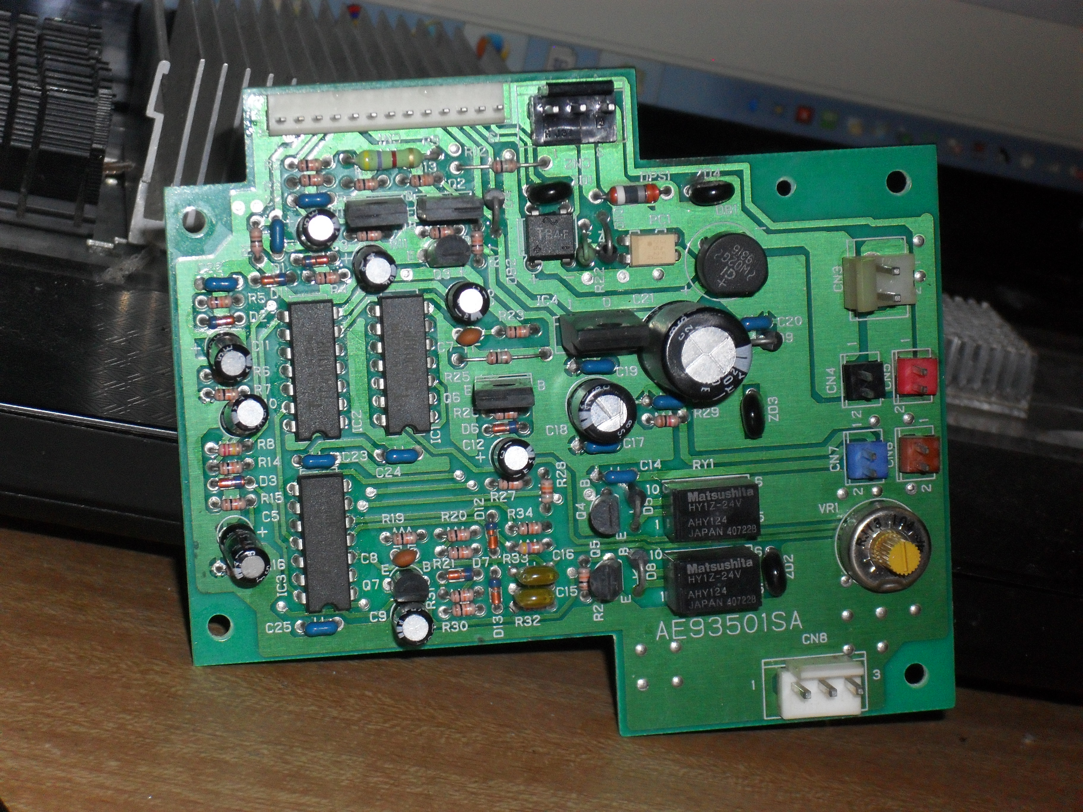

Here it is fellas, thanks for the great response :)
Its from a 1980's pachinko (japanese pinball)
By the way I know nothing about electronics, but I'm willing to learn (I'm a computer programmer for the last 30 odd years so please don't hold it against me)
Specs : 24 volts AC 3 amp 100VA
The black connector right of the 13 pin connector is where the 24 volts AC goes in the other 4 colored ones go to the machine

Thanks. So it is a 47V MOV.
This is used for protection against voltage surges. If you remove this component it will not affect the operation of the circuit. It is faulty if it registers with low resistance when removed from the circuit board.

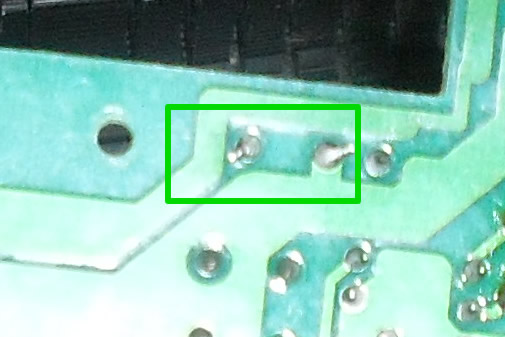

Remove the component. If the board does not work you have another fault some place else.
Here is the back of the board with the component connections marked; do I need to jumper where I remove it to maintain the circuit and if so how;

If it is a MOV/Varistor it is a protection component and the board should function correctly (but sans protection) without it as MrChips says.
No do not put a link in its place. That would short something.

I hooked up a brand new 250v Primary 24v secondary transformer turned it on and [SMOKE, SPARKS etc.] I instantly turned off the power.
I know it failed because once looking at the board I saw this (pic below) hard to miss huh :p
The reason for failure could be that the machine has been sitting in a warehouse for 25+ years unused so it may be just an age thing

Remove the thing and test the board. Do not jumper across because that creates a short.
Worry about sourcing the component later after you are happy that the board works.

Its a metal oxide varistor - IIRC: it loosely follows the standardise component value scheme, except it stands for voltage.
The first 2 digits are base value and the "0" is the multiplier - so I'd say its 47V.
Looks like the Matsushita trade mark on it, they probably have data/catalogues online.
