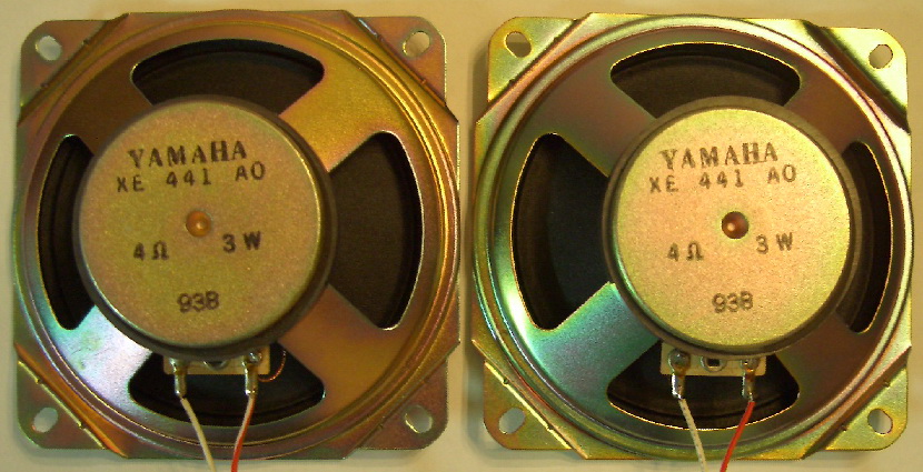

I have these 2x3W Speakers:

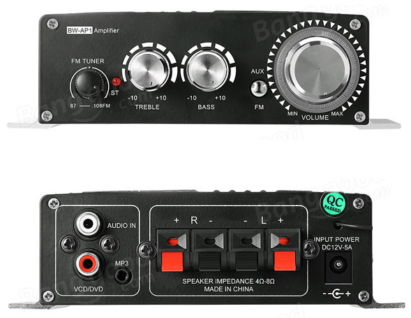

They are not connected to anything, and I want to buy them an amplifier,
so I can connect some Line Out of it, and thus use the speakers.
I saw this amplifier, and it seems nice:
http://www.banggood.com/BlitzWolf-B...r-Digital-Car-Amplifier-FM-MP3-p-1053566.html
This amplifier is based on a TDA7297 amplifier chip.
My question:
Is it a good amplifier for these speakers?
And,
is there any better option for them, in addition to this one?
The important parameter for me is not high volume, but sound quality.

It will drive your speakers just fine providing you are very careful with the volume control.
RMS Power is 20W *2 Channels, and the actual output power is 10-15W.
It will destroy the speakers with ease if you turn it up.
The biggest determinant for sound quality isn't the amplifier, it's the speakers and the enclosure they are mounted in. They don't look particularly hi-fi to me.

So from what you say, because the amplifier is 2x15W, and my speakers are 2x3W,
it means I should really be careful when rotating the volume potentiometer?
Thank you for this, I will be sure to be careful.
BTW, I have a small idea..
Maybe I can modify the amplifier (whichever one that I buy) so the volume potentiometer will not reach above a certain level?
Is the potentiometer in amplifiers connected in such a way, that more volume = more resistance from the pot?
Or the opposite way, more volume = less resistance from the pot?
If more volume = more resistance, then I can modify the amplifier by replacing the pot to be one that is a 1/5th resistance of the current pot that they use.
(1/5 because 15W to 3W)
If more volume = less resistance, then I can modify the amplifier by adding a resistor in series with the pot.
The resistor's value will need to be 4/5 of the resistance of the current pot that they use..
Are these solutions good?

No, that isn't going to work because the volume doesn't only depend on that pot. The input level also changes the volume. So wherever you set the pot, a big input can still produce the maximum output power and I don't know how long it would take to damage them. It is unlikely they would be damaged immediately so, with care, it should be OK.

Those look like inexpensive, small speakers so your sound Fi is not going to be very Hi. ;)

The story of the current speakers, is that I took them apart from a synthesizer I had used a lot in childhood.
I remember their quality, it was very good (despite what people might think from their picture)
As can be seen their mfrr is Yamaha..
They are from the good days where things were mfrred in Japan..
So I thought to use them..
Also they are 11cm in diameter, what you will not get from a BT speaker..
(at least not from most of them)

I wouldn't worry about burning them out too easily with a 20 watt rated amplifier. Most of those small lower wattage speakers take a substantial amount of overloading surprisingly well.
Typically you will hear the voice coil bottoming out on hard base notes well before you reach the instant burn down wattage point. ;)
