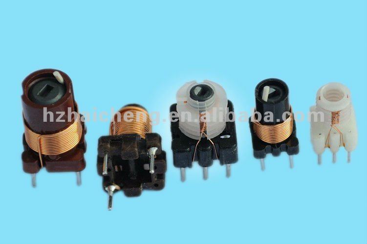

Does anyone have an idea what L1 is in this circuit?

Hello,
The choke can be made with a resistor where about 20 turns of isolated wire around it.
The ends of the coils can be soldered to the wires if the resistors.
Bertus
