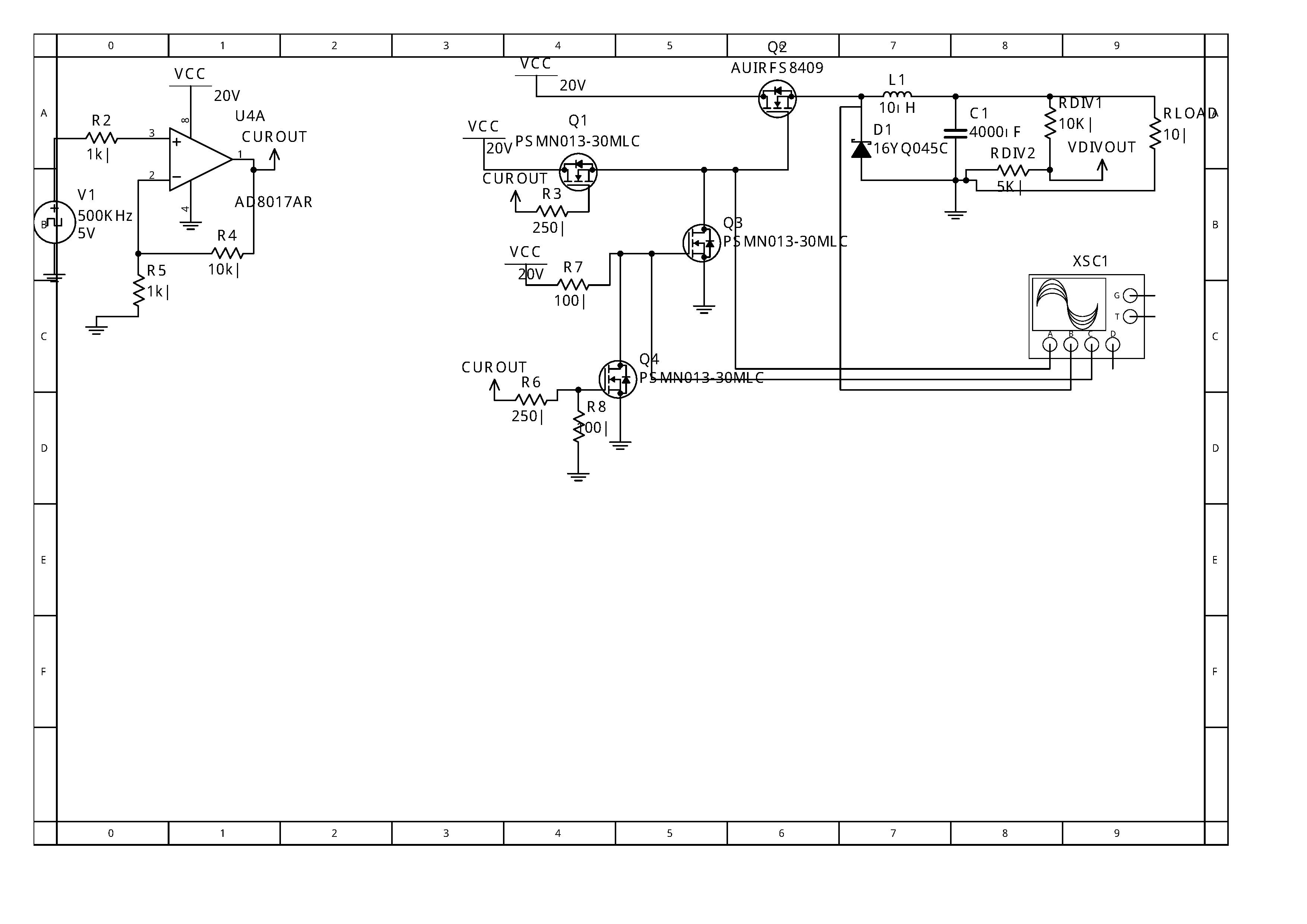

So, here's a better image where I did some refinements, made it look nicer and stuff like this.
Taking into account the Input Voltage to be between 24 and 18 V, I have simulated the correct PWM to be Between 65-45 (for Heavy-Light Load) and 75-55 (Same but for 18 V)
So I made the usual buck converter setup using an extremely low RDS(On) N Channel MOSFET (we are talking less than 1 mOhm "Low").
Inserted it together with a decently sized ideal inductor and oversized ideal capacitor and a 16 A temporary diode while waiting to make it synchronous with another AUIRFS8409.
The PWM is, as already said, generated by a PIC MCU via software, which has a feedback loop via The voltage output divider RDIV1-2 (Which converts a maximum of 15 volts to 5 theoretical volts - perfect for ADC Sampling), at a frequency between 750 KHz or 1 MHz.
The output of the MCU, being inherently not enough to drive anything useful, it sent to a High power Current amplifier which converts it to a respectable 22 V - 100 mA Output - Perfect to drive the low capacitance MOSFETS.
The output is then sent (and also inverted) to the two low-capacitance mosfets used to turn on and off the main Mosfet, ensure it doesn't fall into some sort of "unknown linear state" or simply gets turned on/off too slowly for my necessities.
What am I overlooking here, except lacking synchronous rectification and using uncorrectly sizes Inductors and Capacitors?

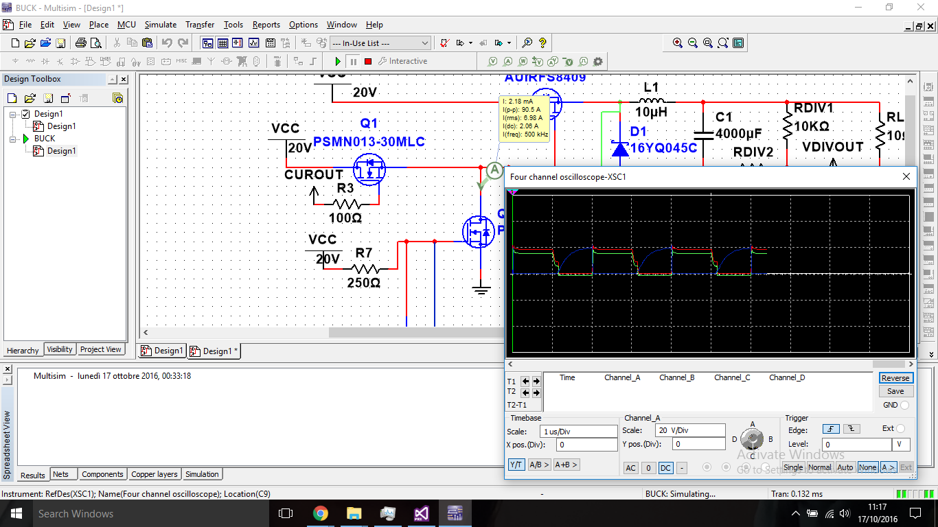

I noticed, running a simulation on Multisim, that the current taken by the MOSFET reaches levels of 100 A - 400 A, is this a simulation error or should I do something to prevent excessive input current? And if so, what is the best choice for this level of power?
Also, is the way I setup all these components wrong? Could I obtain similar results with lesser components?

Hi Lorenzo and welcome to AAC.
I see a couple of things to at least worry about from the hardware standpoint.
I think the gate to source voltage on the FETs is 20 volts. So in the case of 24 volts input it will be to much.
The 2 FETs that drive the big one will have some overlap where they are both on. This may be destructive.
With the large gate resistors in the drivers they will be to slow to run at 500KHz.
I think 24 volts is to high to run the high speed op amp.
You should be able to use a much smaller filter capacitor.
I would be concerned that the micro may be to slow to use to close the loop for voltage control. Think about an all hardware design.

I mostly see what you mean. They are effectively going beyond reccomended values when they have 24+V
And I also thought about the overlapping issue, even though it shouldn't be a problem since the OFF Mosfet is supposed to turn ON slower than the ON mosfet does.
when simulating it, I get these values:
so i'm not sure if I should be concerned or not about that.
The simulation doesn't show any issue with the resistors limiting the switching capability of the MOSFET, i chose them for the exact purpose of having a low gate charge (and thus be able to turn off with smaller current values), even though I could also use a second OP Amp to drive both MOSFETS and negate the input of the first OP AMP on the second (thus creating an effective NOT Gate)
However, I don't understand what you mean by using a smaller filter capacitor (you mean I can get away with those massive 4000 uF? I thought so too)
And with the MCU being too slow "to use to close the loop for voltage control." what exactly do you mean by that? Do you think a 32 MHz MCU is not enough to drive a 500 KHz PWM input?
Anyway, thanks for your actual suggestions, I will look into either lowering the Input voltage or getting higher voltage components. Or a third unknown solution like using a 20V regulator to ensure everything works as expected (but I think it would be a bad idea).

Mmm, I missed the biggest problem. Q2 needs to be a P channel or you need to use a high side driver.
I think for a start try using an IR2184 driver. Then you have everything you need to drive both the pass transistor, but also the synchronous FET.
Maybe just something like a 7812 to produce the voltage for the gates.

Yes, NFET is better, but to turn it on all the way the gate needs to be 10 volts higher than the source. Since you don't have a 30 volt supply it will act like a source follower and get very hot.
The drive will give you the higher voltage. I'll draw one up.

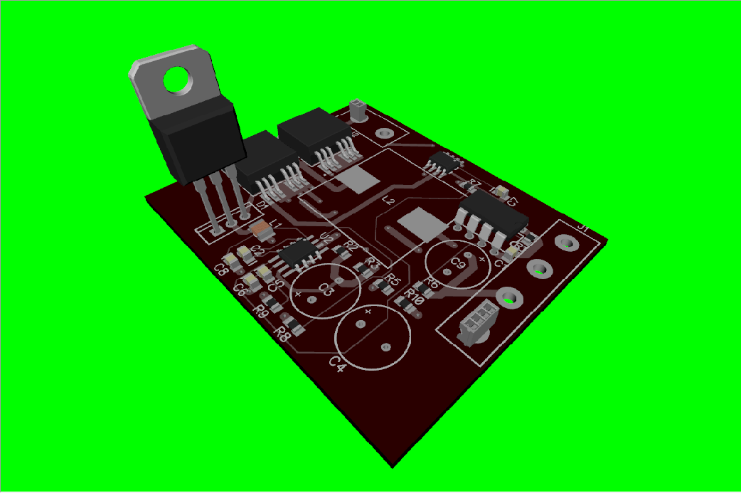

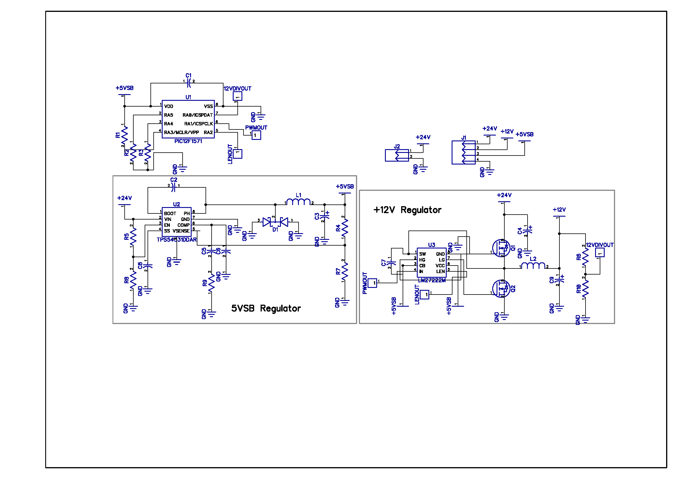

So, your suggestions opened a spark in my eyes, so I decided to go the "fuck it" way and went full digital / full integrated.
I created a 5 V rail for the 5VSB Using a TPS54531DDAR 5 A Buck converter
For the 12 V I went with a synchronous LM27222M MOSFET Driver which is also powered by the 5 A Buck Converter
For the MCU I went for a PIC12F1571 for it's low pin count (8), fast frequency (32 MHz) and ADC / PWM Capability, which will be used to drive the driver effectively, providing added security.
I went ahead and made both the schematic and the PCB, and I'd love to hear your suggestion about it:

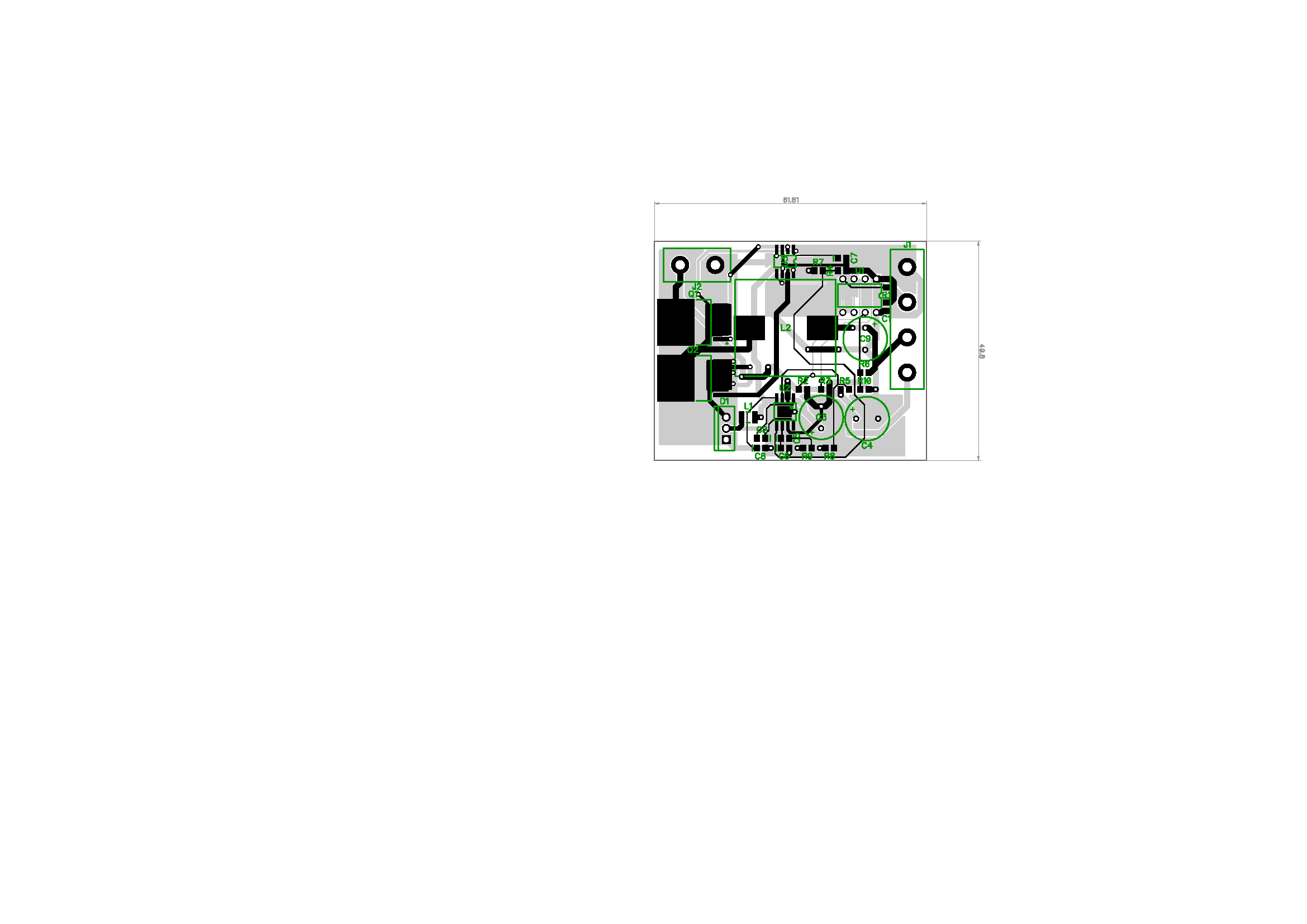

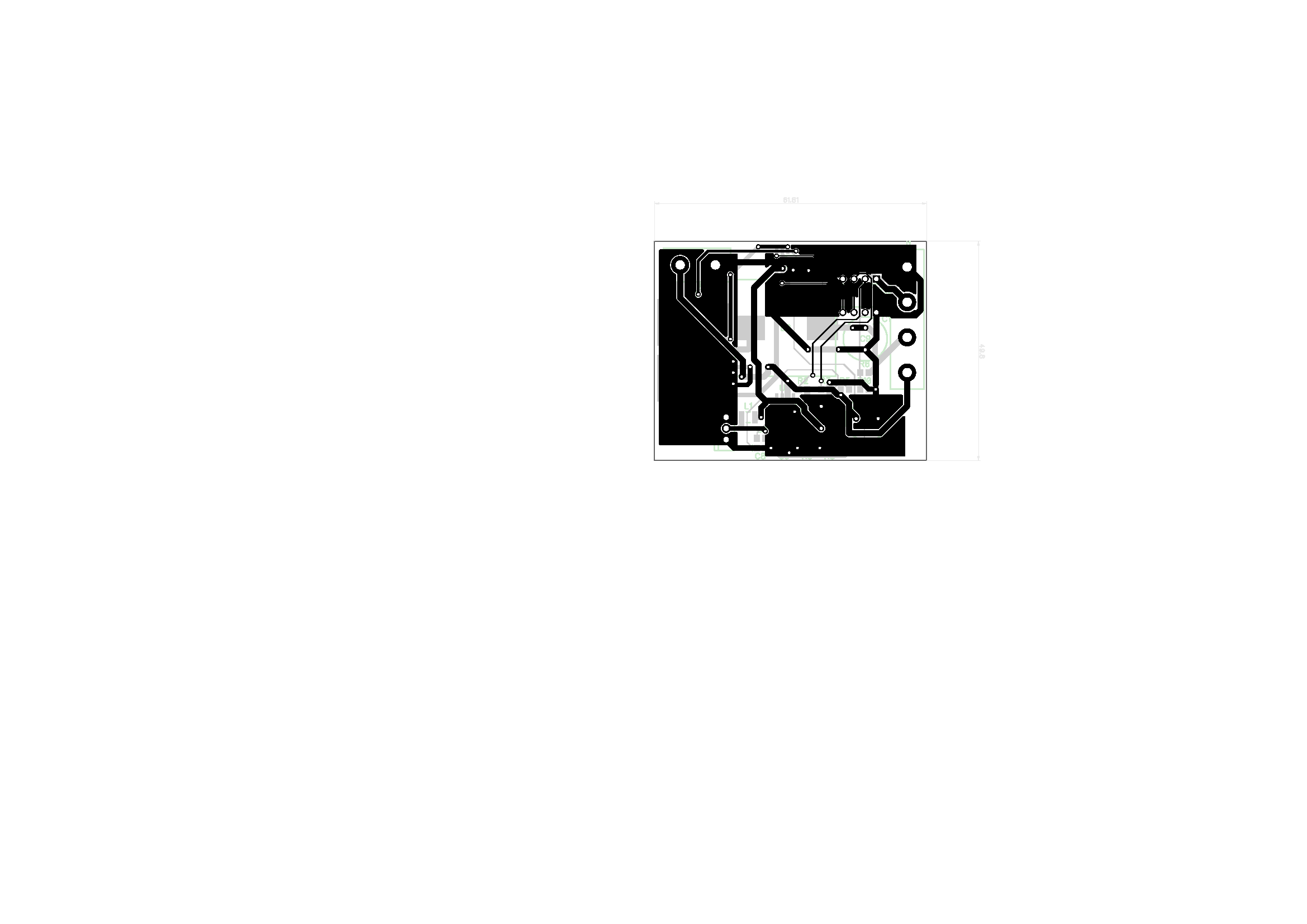

Either way, I'm more than happy to post PNGs here, so here they are:
SCHEMATIC:
TOP PCB:
BOTTOM PCB:
3D View:
I actually designed this solution to let me put a decently sized heatsink that attaches to both the Diode (TO-220AB) and the two MOSFETs (d2pack-7). I also made custom 2mm holes to let me directly test this circuit with a 6p test battery.
