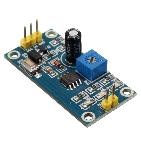

Hi clever folks.
I was searching for a solution to my problem, found something similar in your forum but it wasn’t quite what I was after, so I joined up in the hope that you might be able to help.
We have small bottles of insulin that are used twice a day, that have to be kept refrigerated. If they are left out of the fridge for more than a couple of hours they’re ruined, and they are very expensive.
I am trying to build an alarm to prevent this from happening.
So I made a holder for the bottle, with a switch at the bottom which is ‘closed’ when the bottle is lifted out.
It would be very annoying if the alarm went of as soon as you removed the bottle, so what I wanted to add was a delay of, say 2 minutes [to allow someone to take the bottle out and fill a syringe] before an alarm goes off to remind them to replace it.
I have very limited knowledge of electronics, though I’m fairly logical and know which end of a soldering iron to hold.
I bought this unit to function as the delay, hoping to use it with a 9v battery and a buzzer of some sort (which I have yet to source), however it came with no instructions or schematics and I can’t get it to do anything useful.
thanks in advance for any help!

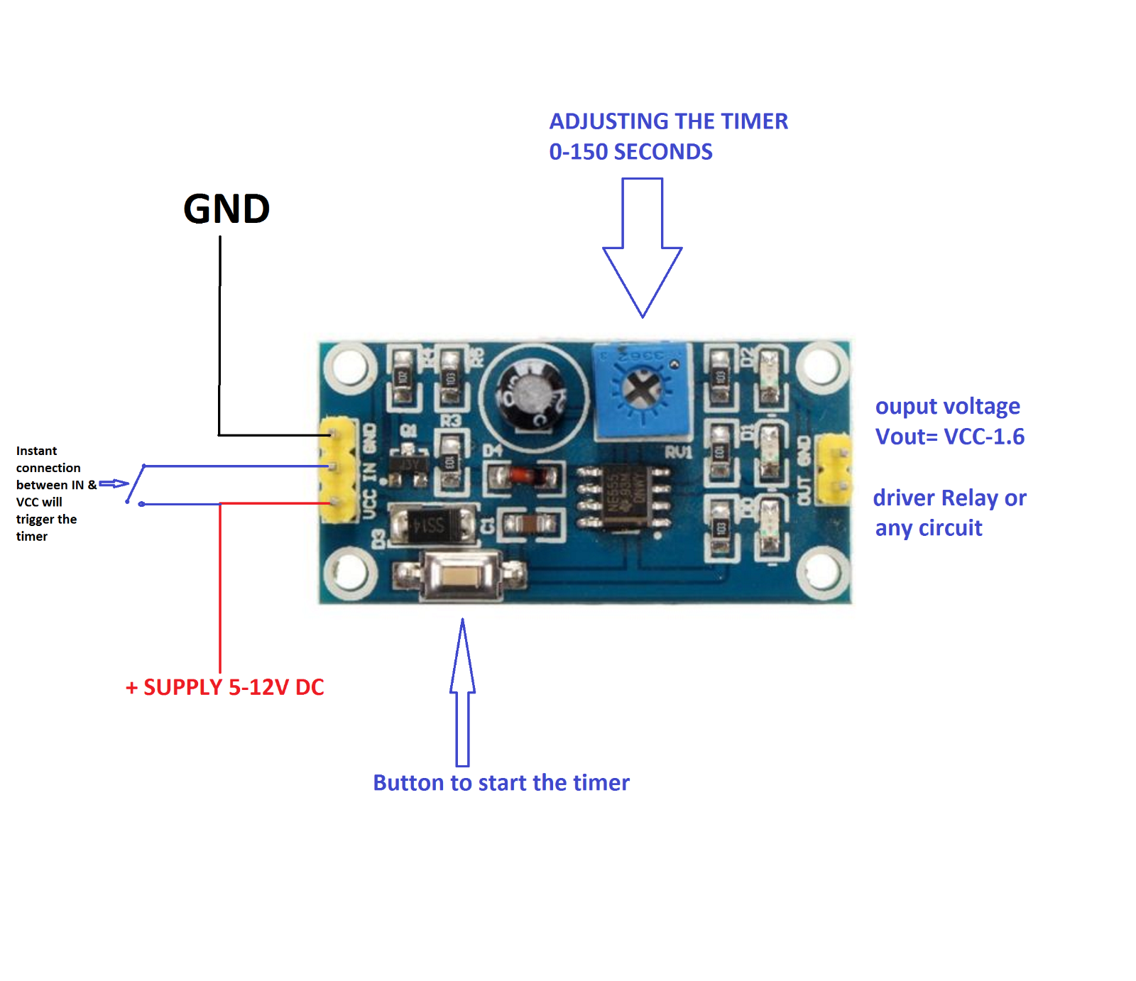

Hi again
OK… so my 9v battery is measuring 8.72v.
With battery connected + to VCC and - to GND (on the left hand side of the diagram above), the output (across the terminals OUT / GND on the right hand side of the diagram above) measures 0.05v.
If I then connect IN to VCC output is 7.2v.
If I then disconnect IN from VCC output drops back to 0.05v after the user-set delay time.
Does that help?!
Seems like that's pretty much the opposite of what I'm after...?

Try connecting a capacitor, perhaps 100n, from IN to VCC then monitor the output as you connect the power.
With a bit of luck the output will go high for the delay time...

But surely I want the voltage to be low for the delay time, then go high enough to activate a buzzer afterwards?
I'm afraid I don't have any components, would have to order them in, so this might take a while. I get the feeling I'm wasting your time here, and maybe I should just do some research and but the right module in the first place...?
ncklln
Joined Jul 18, 2018
14
Aha! Just tried that and it works, however only if the timer is manually triggered. The timer doesn't start automatically (I tried with and without IN connected to VCC)

Hello again. Well, I got the the components you recommended, and it nearly works! Thanks so much. The only problem is that when I connect the battery, the voltage between the output pin and VCC is 1.5v, and then when the timer is up, it jumps up to 9v. So the buzzer comes on immediately and then changes pitch after the set time, rather than coming on after the timer has elapsed. So close. Any ideas?!
