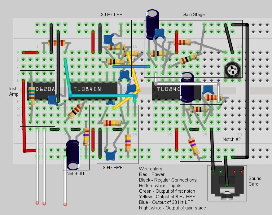

hi everyone. Im using ad620 amplifier module. The aim is to get an amplified sine wave. The problem arose right after the beginning: the sine wave on the output was way too destroyed. I thought the issue was with 7660 dc-dc converter, that didn’t provide the stable -5v, so I deleted it from the circuit and used another voltage source to make an external bipolar supply. Nothing changed. The picture of the oscilloscope is below.
I use waveform generator for sine wave generation.
connection: Vwg- S+
GND(wg) - gnd
V(+5V) - Vin
V(-5V) - V-
Oscilloscope - Vout

I also tried to connect s- to gnd of the waveform generator but it wasn’t the issue. I found out that signal inputs should have a path to the ground via resistors. And it worked. Thank you for advice

regarding the gain settings I set it according to the oscilloscope avoiding the clipping for the 100mVpp signal. But the bridge thing didn’t come to my mind. I want to use this module to prototype an eeg device, so, I guess, there is no need for bridge circuits. My hypothesis is that I can wire s+ to the scalp and s- to the ear reference electrode and get the right signal on the output.

Oh Wow!! That is a very different application for an instrument amplifier. What will be an issue is the "common mode" voltage, because while the IA is amplifying the difference voltage between the two inputs, there is also the difference between those voltages and the "zero voltage reference " of the IA system. For an explanation of how to deal with the common mode voltage I suggest the ANALOG DEVICES website for information, because the typical Parts Seller will not have a clue as to what that is. And from amazon will be much less than that.
It may also be that others reading this thread know a lot about working with common mode voltages in an EEG type of application.
