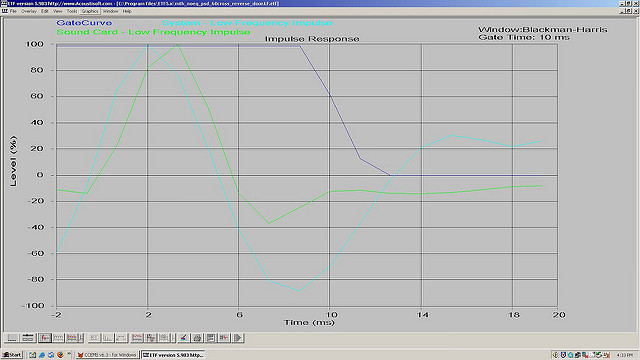

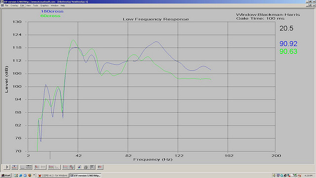

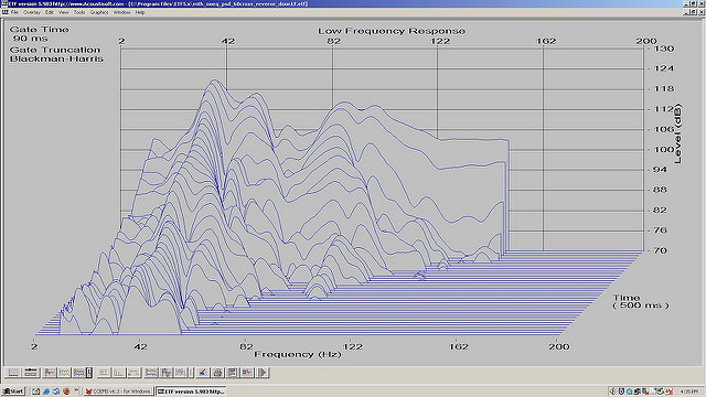

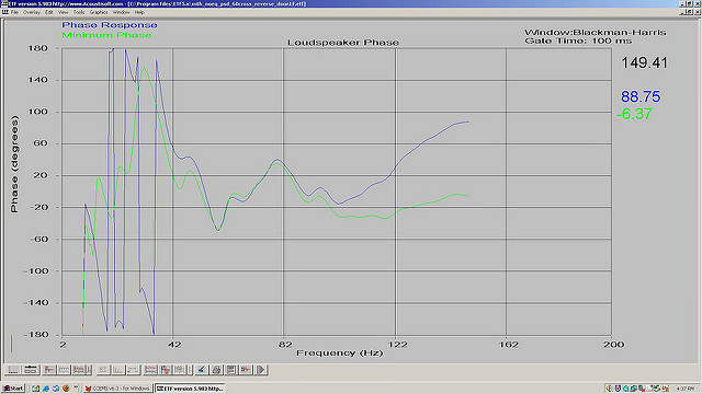

RANT. Computer room acoustic correction is usually taking a crappy sounding room in all listening positions and maybe making it sound somewhat better in one location. This usually makes all other positions sound even worse. Passive room correction with panels, damping, corner traps and proper speaker placement makes most of the entire room a listening pleasure with minimal need for electronics.
For a PC you will need a calibrated microphone (line output or preamp) and a good sound card to use this type of software. http://www.etfacoustic.com/
I used an older versions for my HT and car sound calibration.
I'm sure today are apps today for phones that might also work but it's unlikely they will be better than this.

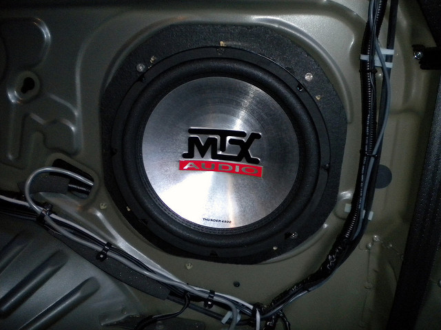

OEM speaker
no eq, no crossover
Replacement
New speaker installed with acoustic batting and EPDM rubber damping in the car speaker enclosure
http://audiojudgement.com/speaker-impulse-response/
https://www.stereophile.com/features/99/
