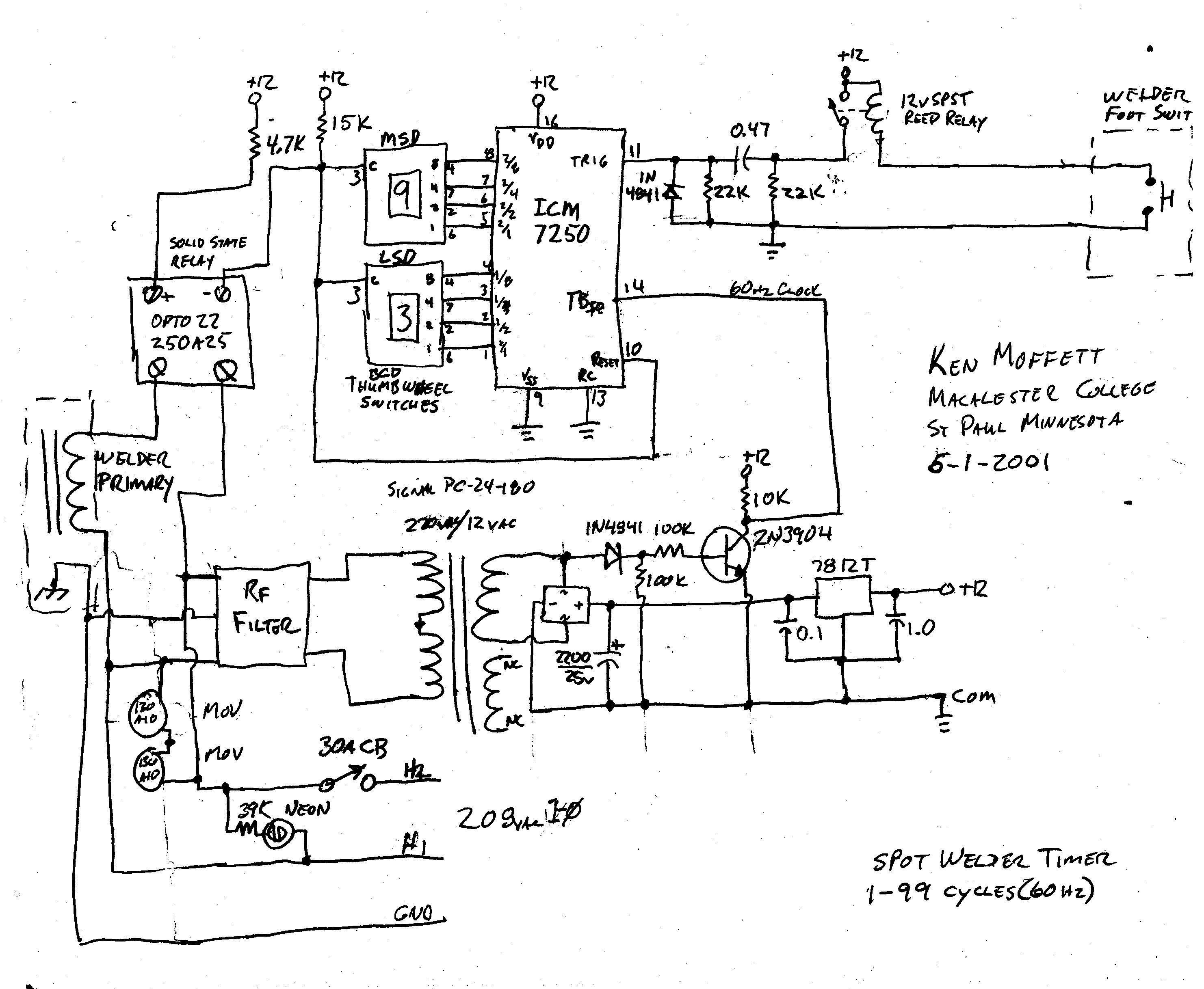

Hi, folks.
I have a project in mind wherein I would need to leave a circuit energized for a specific number of AC cycles. I think I've got my head around most of the counting part, but what I haven't been able to figure out is how to create a trigger that fires once per cycle. I'd prefer to do this based on witnessed cycles as opposed to using a timer set to fire at 1/60th (or 1/50th) of a second.
Basically, the goal here is to create a CLK trigger once per AC Mains cycle.
Anyone able to point me in the right direction?
Thanks,
-Ben

Use a zero crossing detection set up, you could probably do it with a variation of the triac trigger circuits in Fairchild App note AN-3006.
Integrating with either a logic IC or microchip.
Max.
KMoffett
Joined Dec 19, 2007
2,918
I did that for a Miller spot welder at work. Thumb wheel switches and a down counter. One pulse/cycle from a half-wave rectifier and transistor off of the low voltage DC supply transformer. I'll see if I can find the schematic Monday.

Super helpful, thanks folks!
Ken, I suspect your solution is the best fit for my project. I suspect I can figure out the details, but if you have a diagram lying around I'd love to see it!
Ken
Were you controlling exactly what? The time the voltage was applied to the piece being weld?
benha
Joined Jan 4, 2011
76
I suspect so. A spot welder is, in fact, the exact thing I'm building.
The standard unit of measure for a spot welder's weld time is the number of AC cycles power is applied.

Do you need that much precision with for any simple spot welder? most weld take place over many cycles, and is commonly done in the industry with a simple timer to control the firing element, often a large contactor.
Pulse counting is usually done with seam or projection welding where the weld repeats and cycles rapidly.
