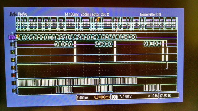

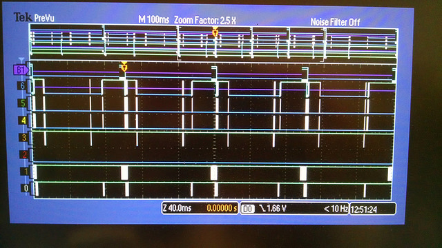

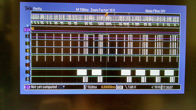

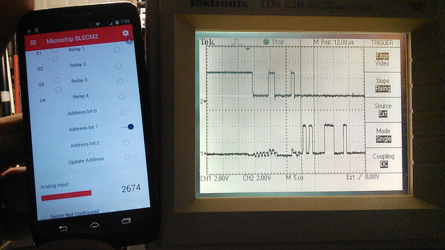

You need to send null clocks before the start bit. The dummy8 of A_data will be auto aligned/padded by the compiler to the correct storage boundary for the structure so we can use a union to send the correct 3 bytes of 4 and 24 bits to the ADC.
24-bit spi mode 0,0 transmit sequence in the C structure with union overlay to long and 4 byte array.
https://forum.allaboutcircuits.com/threads/pic24-bluetooth-low-energy-dk.128497/#post-1056985
SDO to ADC
SDI from ADC
ADC spi data: top command, bottom response.

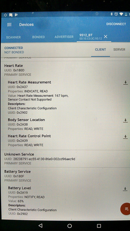

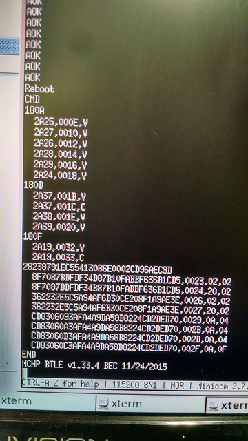

I've modified the original demo code to add a few public services for examples. The ADC value now updates the heart rate and battery level characteristics. The 'downsides' (if you run a earlier version of firmware) of this code addition is that RN4020 firmware 1.33.4 is necessary now for proper operation. A upgrade to 1.33 is highly recommended.
GATT LS command during PIC24 boot of services.
Discovery using nRF Connect Android APP https://play.google.com/store/apps/details?id=no.nordicsemi.android.mcp&hl=en_US
'Unknown Service' is the private service defined in the RN4020 PIC24 software.

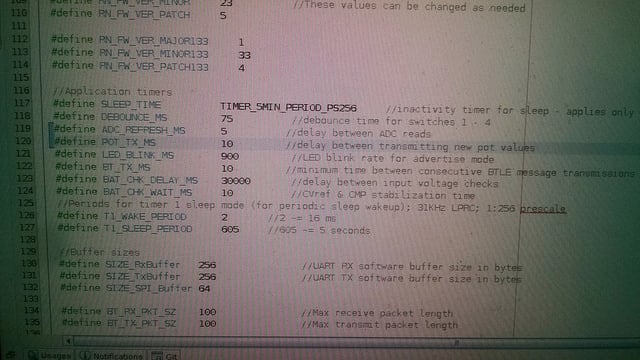

C:
////////////////// #define code fragment
//BTLE services
#define PRIVATE_SERVICE            "28238791ec55413086e0002cd96aec9d"
#define PRIVATE_SERVICE_SPI        "8ee15902ee6f49dc9cfb5c4c2eff6057"
#define PRIVATE_CHAR_SWITCHES        "8f7087bdfdf34b87b10fabbf636b1cd5"
#define PRIVATE_CHAR_POTENTIOMETER    "362232e5c5a94af6b30ce208f1a9ae3e"
#define PRIVATE_CHAR_LEDS        "cd8306093afa4a9da58b8224cd2ded70"
#define PRIVATE_CHAR_RELAYS        "cd83060a3afa4a9da58b8224cd2ded70"
#define PRIVATE_CHAR_ADC_CHAN        "cd83060b3afa4a9da58b8224cd2ded70"
#define PRIVATE_CHAR_PIC_SLAVE        "cd83060c3afa4a9da58b8224cd2ded70"
// Battery
#define PUBLIC_BATT_UUID       "180F" // Battery level service
#define PUBLIC_BATT_CHAR_BL    "2A19"
// Heartbeat
#define PUBLIC_HR_UUID         "180D" // Heart Rate service
#define PUBLIC_HR_CHAR_HRM     "2A37" // Heart Rate Measurement
#define PUBLIC_HR_CHAR_BSL     "2A38" // Heart body sensor location
#define PUBLIC_HR_CHAR_RCP     "2A39" // Heart rate control point
// handles that change with added services and characteristics
// manually parse the LS command for UUID handles
#define PUBLIC_BATT_CHAR_H        "0032"
#define PUBLIC_BATT_CHAR_C        "0033"
#define PUBLIC_HR_CHAR_HRM_H        "001B"
#define PUBLIC_HR_CHAR_HRM_C        "001C"
#define PRIVATE_CHAR_LEDS_H        "0029"
#define PRIVATE_CHAR_ADC_CHAN_H        "002D"
#define PRIVATE_CHAR_PIC_SLAVE_H    "002F"
///////////// setup frag
    if (version_code >= 33) { // V1.33.4 public services
        // Public BTLE services and characteristics
        // heart rate service with standard 16-bit UUID
        BT_SendCommand("ps,"PUBLIC_HR_UUID",\r", false);
        if (!BT_CheckResponse(AOK)) {
            return false;
        // heart rate measurement characteristic
        BT_SendCommand("pc,"PUBLIC_HR_CHAR_HRM",22,02\r", false); //Indicate, Read
            return false;
        // heart body sensor location characteristic
        BT_SendCommand("pc,"PUBLIC_HR_CHAR_BSL",0A,0F\r", false); //Write w/ACK, Read
            return false;
        // heart rate control point characteristic
        BT_SendCommand("pc,"PUBLIC_HR_CHAR_RCP",0A,0F\r", false); //Write w/ACK, Read
            return false;
/////////////// update frag
        //Transmit new potentiometer reading?
        if (TimerDone(TMR_POT)) {
            //Send message only if pot value has changed
            if (appData.potValue != appData.potValueLastTX) {
                //Form message
                sprintf(appData.transmit_packet, "suw,"PRIVATE_CHAR_POTENTIOMETER",%04d\r\n", appData.potValue);
                //Try to transmit the message; reset timer if successful
                if (BT_SendCommand(appData.transmit_packet, true)) {
                    appData.potValueLastTX = appData.potValue;
                    StartTimer(TMR_POT, POT_TX_MS);
                //Form message
                sprintf(appData.transmit_packet, "suw,"PUBLIC_BATT_CHAR_BL",%d\r", (appData.potValue >> 6)&0b00111111);
                BT_SendCommand(appData.transmit_packet, false);
                sprintf(appData.transmit_packet, "suw,"PUBLIC_HR_CHAR_HRM",%02x%02x\r", 0, (appData.potValue >> 4)&0xff); // format mask and ADC data
            } else {
            } //value not changed - skip this transmission

You wrote blocking code! Heathen!
joeyd999
Joined Jun 6, 2011
6,461
Every time you send a command to the 4020, you are waiting for a response: either AOK or ERR -- thus setting the return value for the call TRUE or FALSE. The code stalls until the response is received.
This is worse when you use the Indicate bit: you must wait for two AOKs until (a send acknowledge (from the 4020) + a receive acknowledge (from the host)) the function returns.
This would blow my apps out of the water.
Note: the response time is also indeterminate. Much depends on the integrity of the radio connection -- and other traffic -- and where you are in the "slice" time of the Bluetooth protocol.

BT_CheckResponse has a timeout so it will fail with no response but I didn't write that part of the code so I'm not the Heathen this time! I'm planning on a rewire of much of the init and control logic to something that will auto configure services, handles and characteristic as they are added but it's not a top priority.
C:
bool BT_CheckResponse(const char *data)
    uint16_t i, ByteCount = 0;
    char NewByte, Buffer[50], *BufPtr;
    StartTimer(TMR_RN_COMMS, 600); //Start 600ms timeout for routine
    BufPtr = Buffer;
    while (ByteCount < 50) //Don't accept more than the buffer size
        if (UART_IsNewRxData()) //Check if new data byte from BT module and return if nothing new
            NewByte = (char) UART_ReadRxBuffer(); //Read the data byte for processing
            *BufPtr++ = NewByte; //Add it to the buffer
            ByteCount++;
            if (NewByte == '\n') //Check if got linefeed
                break; //If linefeed then we have what we want
        if (TimerDone(TMR_RN_COMMS)) //Check if timed out
            return false; //If timed out then return failure
    BufPtr = Buffer;
    for (i = 0; i < ByteCount; i++) //Compare all bytes received
        if (*data == '\0') //See if reached end of string with no bytes different
            return true; //No bytes were different so return success
        else if (*data++ != *BufPtr++) //else see if the bytes are different
            return false; //Bytes differ so return failure
    return true; //All bytes matched so return success

Just so you recognize the impact, let's talk about what happens with your SUW command. I will reference the PIC18, not the PIC24, as I don't use that.
First, my code runs at 8Mhz, so a Tinst of 0.5uS. I'll assume the RN4020 native 118kBaud (84uS/byte or 170 Tinst/byte).
We both have to send the command to the TX buffer -- no issue there except I use SHW (send by 4 octet handle) instead of SUW (send by 32 octet UUID). This saves me some time.
Next, you have to wait for -- i.e., "SUW,362232e5c5a94af6b30ce208f1a9ae3e/r/n" -- 38 character times, or 6,440 Tinst just for the command to clear the buffer.
Then, the 4020 must parse your command, wait for an appropriate time slice, and send it to the host. Tinst is undeterminate.
The 4020 must then formulate a response -- either AOK, ERR, or FAIL, and then send it "AOK/r/n". Another 848 Tinst.
Finally, the PIC must parse the response and compute a TRUE or FALSE and return to your calling routine.
This is such a significant waste of MCU cycles. Like I said, this'd kill me. I usually have far too much going on in the background to let the CPU stall to a halt for >> 10,000 Tinst.
Writing non-blocking code for the RN4020 is hard.

Sure, I took a quick look at the throughput with the MSO. For what I'm doing it's fine but I see room for improvement by using handles instead of long private characteristics.
[0..1] RN4020 rx/tx lines, [4..6] SPI clock/data with [3] 3208 ADC select line.
Normal update timing.
Cranked up the ADC refresh and POT message rates.

Remember: if you choose to reference private characteristics by handle, you must enumerate them using the LS command during your configuration process. In fact, since I assume the flash in the RN4020 has a finite write life, I use a 3 step process when I configure:
1. Send LS. Read private characteristics (if any) and capture handles and compare with desired configuration
2. If configuration is not correct, clear existing configuration, write new configuration.
3. Send LS. Read private characteristics and capture handles.
Steps 1 and 2 are done in the same routine (processed once for each read/write private characteristic, or twice for each indicate/notify private characteristic (two handles generated)):

Finally, LS blows all characteristic data out at once (public and private). If you are not using hardware flow control, make sure your receive buffer is large enough to capture everything expected.
Here is a typical private characteristic string embedded in program memory and indexed by tblptr above. I use the same string for each step so I don't waste program memory on multiple identical UUID strings:
Code:
sbtspc2 db    "PC,4CD584F575A14A36833C83D0E75BA483,12,14\r\0"

The public battery, heart rate characteristic with demo data server is working in the pic24 example code.
NEXUS 7 Table
Generic BLE Heart Monitor app
Microchip Data app
