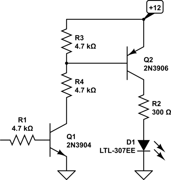

I have designed a digital led clock using 89s52 mic. and pcf 8583p rtc chip. I use a total of 6 digit for HH:MM :SS format. I use here normal multiplexed display technic in which only one digit is active at any instence. It is common cathode type display. and each sigment is made up with 12 leds(4x3led serese) . a uln 2003 driver is used as cathode driver and 7 anodes are being driven by 7 pnp transistors..The clock is running ok, brightness also ok.but some sigments are slightly lit
unexpectedly according to active sideby digit. I use some software as well as hardware tricks to solve it but all in vain.Please
help me.

ScottWang
Joined Aug 23, 2012
7,501
You can compress the vb6 to as vb6test.zip to upload.
Each digit total scan time as 20~40 mS, the best is 33~40 mS.
Each DB140 needs to in parallel with a Rbe resistor as 3.3K~4.7K to turn of BD140 when BC547 is turn off, otherwise when BC547 is turn off then the base of BD140 will be floating and it will causing the oscillation.
The Rbe resistor will be as below:

Many thanks to ScottWang. It was Rbe resistor. I inserted it to my hardware and the display is ok now. many thanks
to all again for your valuable support.
