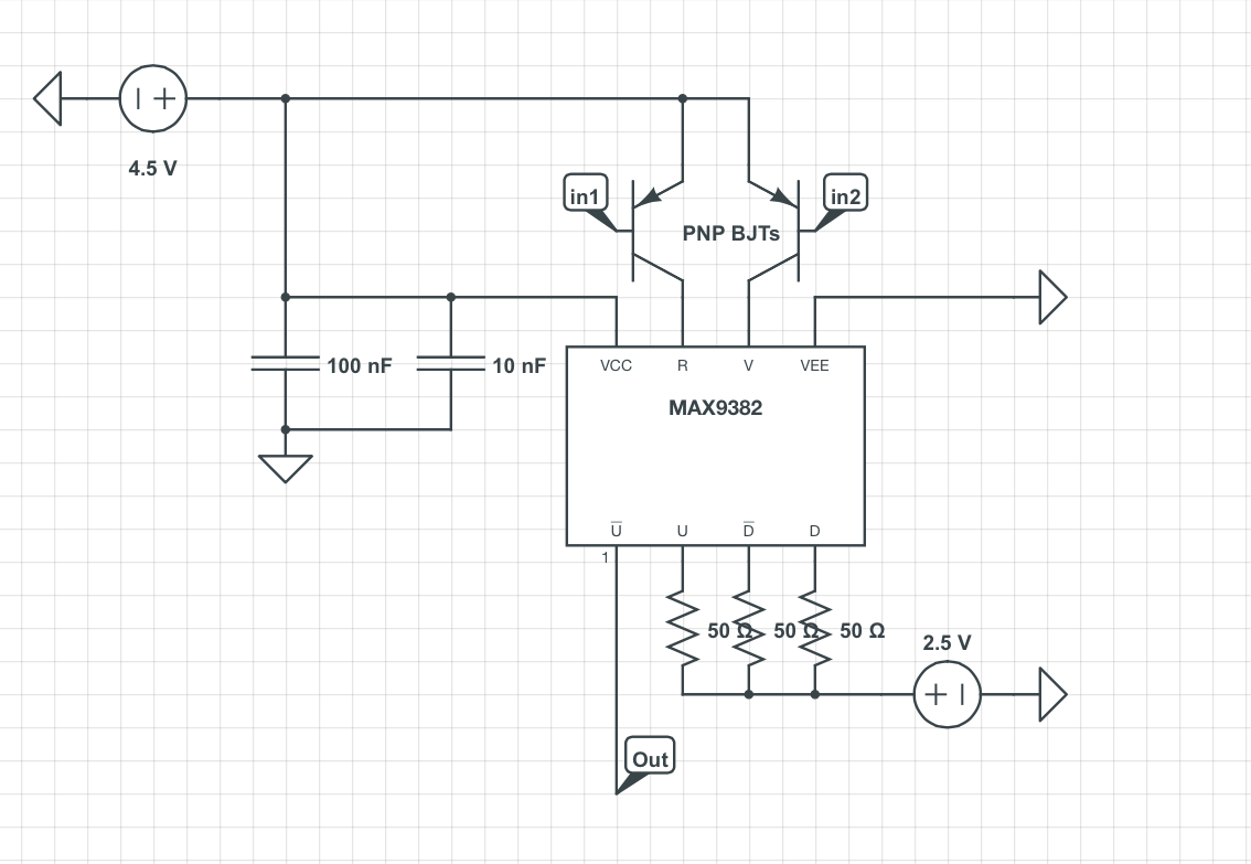

Cery
Joined Nov 27, 2014
7
I've worked out a circuit for the phase-shift detection of my two analog sine wave signals.
What do you think, would this work? I haven't got a lot of experience with things like this.
If this would work which transistors do i need to choose?
I really appreciate any help!
Cery
(in1,in2 433Mhz)
Cery
Joined Nov 27, 2014
7
The PNP transistors are Biased from top to bottom: Emitter - Base - Collector
I wanted to couple those input waves directly to the circuit. Would i need to couple it different?
Papabravo
Joined Feb 24, 2006
22,116
You obviously didn't understand the questions. So good luck getting it to work.
PNP transistors require DC biasing to put them into their linear range.
High frequency signals would normally be AC coupled. Direct coupling has problems.
Also, run of the mill PNP transistor won't work in this application.
Cery
Joined Nov 27, 2014
7
Sorry I didn't understood this simple Question.
But i hope i understand now. And now i also understand why my circuit wouldn't work this way.
I'm connecting my input signal directly to the Base so the BJT only conducts when my analog input signal is positive. I thought this would act like an ADC but unfortunately this wouldn't work because the saturated state is reached only when the input signal is High enough. Resulting in significant smaller high states then low states in the resulting digital square wave. I would need a BJT which reaches the saturated state with really low input voltages, with zero...
I guess there are even more flaws with that.
Thank you for helping,
Cery
