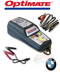

Don't set the voltage to 16V. You stand the risk of destroying your battery.
I have an Optimate (highly rated) 12v battery charger / desulfator. They've been reviewed by many experts.
Depending on the level of Sulfation, they apply a 16v or 22v current to the 12v batteries for desulfation. Maximum current is 0.8 Amps
I was trying to duplicate the desulfation process with my CC/CV DC power supply. (maybe not a good idea)

I am not familiar with that charger.
Here is what I use: NOCO Genius G750
(Edit: Not the one used to destroy the above batteries. I have had a number of SLAB destroyed by over charging when the chargers failed to turn off, from different chargers.)
