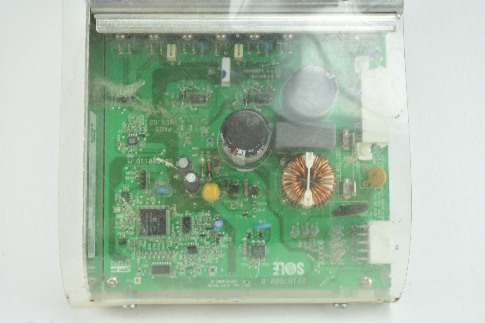

Matt Traven
Joined Apr 17, 2018
12
yes that is the one, here are a couple images.
if you see the "1" in the top left corner, thats what I called igbt1. Using that convention, igbt1 & igbt2 were shorted as described previously.
The molex near the top is : from bottom to top: AC hot, AC nuetral, ground/balance line, 3x motor windings
-so thats power in & output
the one near the bottom is trickier(10 pin connector, 9 used), these are the lines that instruct the driver to run at what speed & direction. But I really have no idea what goes where or even what values the driver is expecting. I have a diagnosis flow chart that says if pin 1 or 9 are less than 50vac (with respect to ac neutral), then replace the timer. Now those values are fine, but from this I think we can infer pins 1 & 9 tell the driver what to do.
pins 3& 4 are easily traced to the tach, if I measure continuity over those and spin the motor manually, i flashes of continuity as I would expect, so the tach seems ok, but I dont know anything about the circuit that reads it.
While I wait and see what you have say, I think Ill try to trace those inputs and see if I cant make more sense of the logic circuit.

dendad
Joined Feb 20, 2016
4,642
There is a fair chance the FET drivers (U7, U8 and U???) are dead to.
How are your surface mount repair skills?
Poking around on this board is potentially very dangerous and unless you know what you are doing, it is best to just replace it. I see there are some on Ebay if you can't get a new one from the manufacturer.

Yah I was thinking those might be bad, looking at those chips, I have the ability to replace them, though I would like to confirm they are bad before I do so.
I have already replaced this board, and a lot of other parts on this washer, not dying to spend another $100 when its probably a $3 component thats bad.
As for poking around, for live measurements mostly I have been soldering wires on so I can do safely measure things. I have done some fractal burning that works with 2000-10000vac, which will kill you as a sure as a gun shot to the head. My point is that I understand the risks.
But poking around the disconnected board last night did reveal a problem: one of the AC connections was broken between the pin & board on the board connector, I fixed that last night. The first thing I do after I have tried the board in the machine and need to work on the bench is discharge those big caps...this time I though it wise to measure the voltage on them before I discharged. I found one was charged to ~140vAC, but the other had nothing on it...fairly certain thats the problem I need to fix now.
