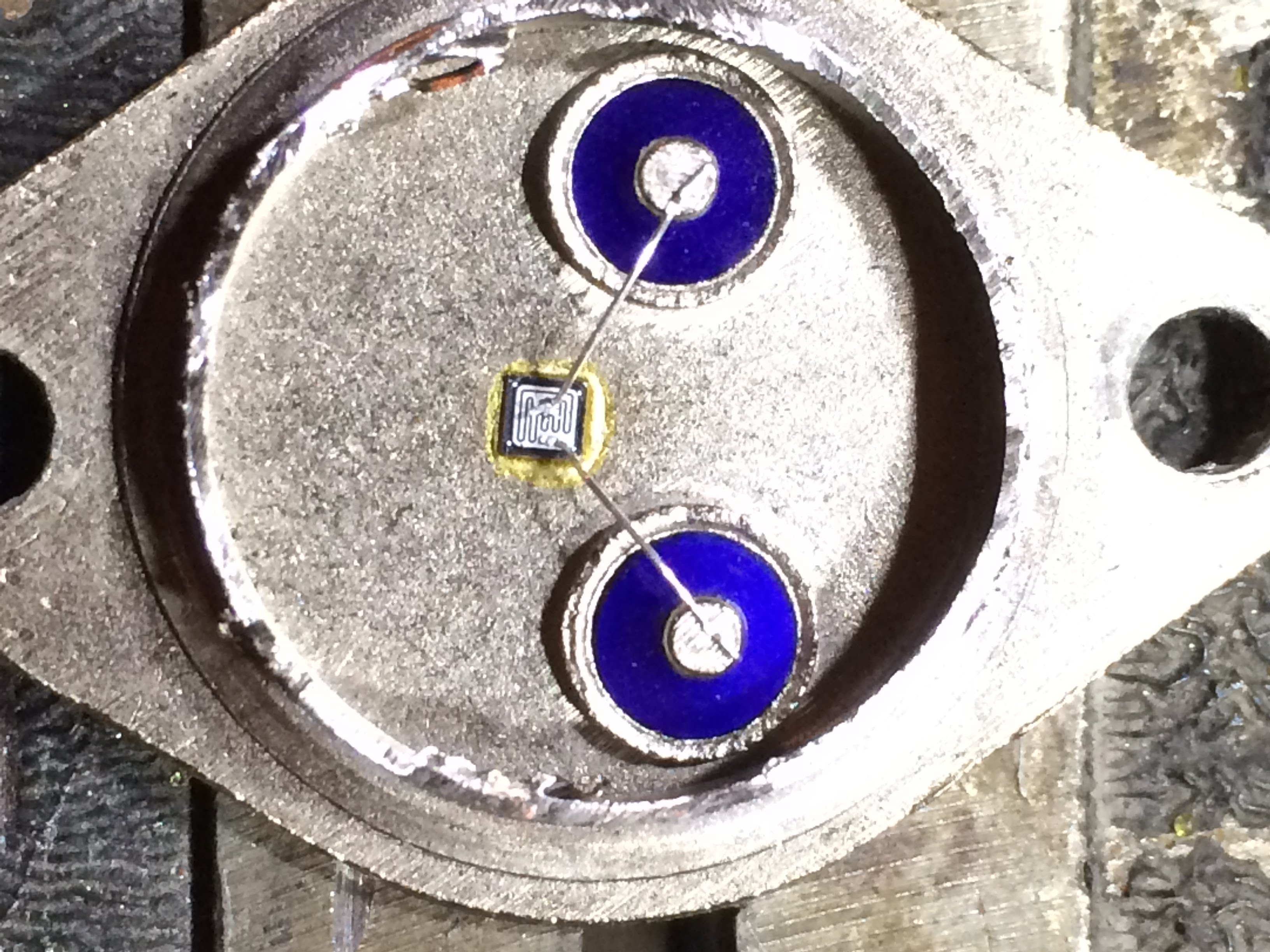

IMO No!Just use a saw to cut just at the top rim. Will there be chemical hazard ?
I like the die size, lead 'caliber' and the presence of the (so called) 'coin' --- Not too crazy about the (apparent) thermal transfer compound though -- that said, my guess is that it's the genuine articleWhat do you say to this.
You seem to have missed the embedded link? Here it is unadorned: http://www.st.com/stonline/contactus/contacts/index.php?type=2Manufacture is China I believe.
While 'premature' breakdown may betray a poorly counterfeited or 'raised' device, it is by no manner of proof that the device is genuine (and, hence, reliable) -- Consultation with the manufacturer is theI guess I need to do a the breakdown test now.
Most thermal transfer compounds are not electrically conductive... Notable exceptions being certain varieties of 'Arctic Silver' and other low quality $#!% marketed for PC applications...Wouldnt thermal compound cause a short since it contains silver or other metals.
