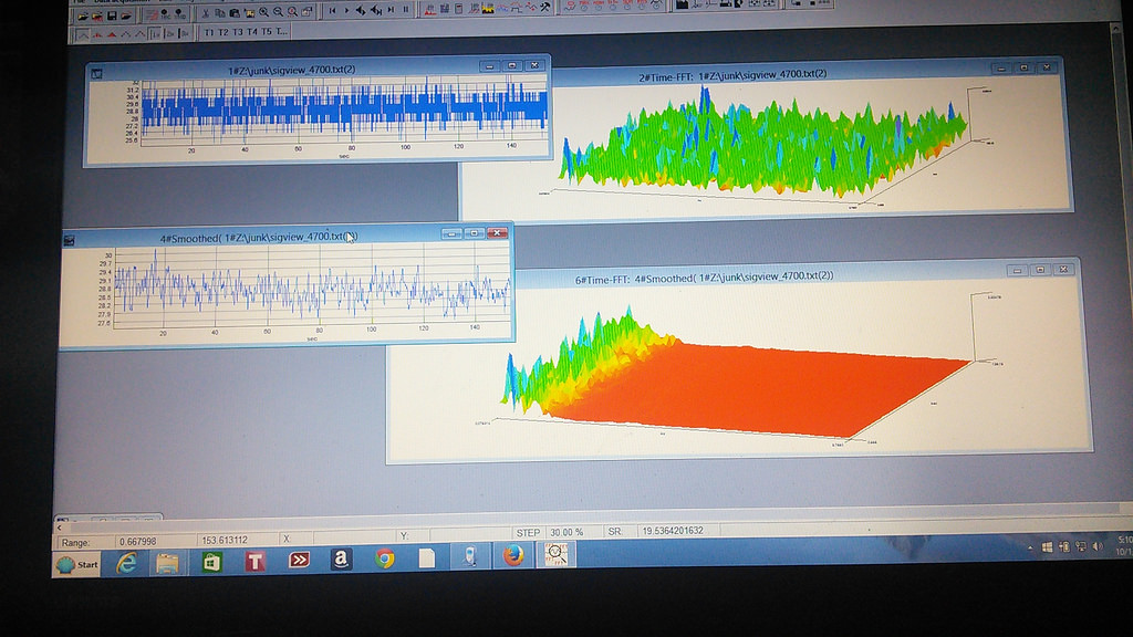

I just used a ADS1220 24-bit sigma-delta converter in a project to deliver 20-bits of needed resolution to measure solar panel power in the microwatt range during moonlight with great stability from a very noisy signal source so it should be possible to use one for your application. Use the information the vendor provides to calculate your design requirements with their device.

Some 19.5 SR FFT data from the moonlight 24-bit sigma-delta detector with the diff inputs shorted and with a 4.7k resistor on the inputs. Gain 4X with 50/60Hz internal filter, internal gain block off. For the moon data collection I only generated samples every 3 seconds so I used a software averaging filter on the raw ADC output to smooth data for that. Not bad for something built on a vector board.:D
I modified the logger program to generate SIGVIEW ascii import files of 3000 samples per file with no processing. X time in seconds, Y value in microvolts
http://www.sigview.com/ 21 day eval.
Input shorted for noise floor for ~10Hz . Top two RAW signal, bottom two smoothed, signal levels in micro-volts.
The 4.7K load resistor generates a small DC offset.
Re-sampled noise signal spectrum:
