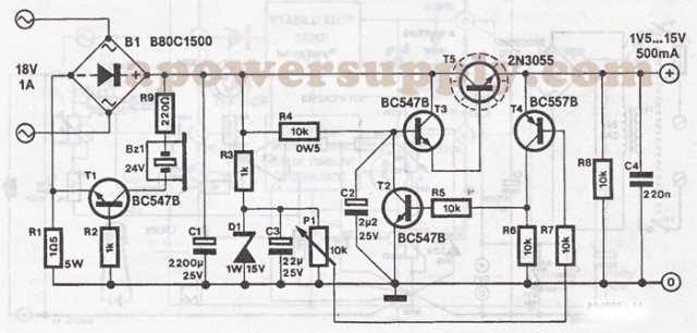

Hello guys, I want to know what is purpose of the transistor T3(BC547B) in this circuit. I understand it provides base current to the series pass transistor T5(2N3055). Also i want to know
1. what is the function of transistor T4(BC557B) and T2(BC547B) and T1(BC547B)??
2. Here D1 (1w,15V) is a zener diode?
3.What is BZ1(24V) in this schematic?

T4 senses voltage, sets by P1, source current to T2 to cutoff T3, T3 stops feeding current to T5
Basically, when voltage rises above reference voltage sets by P1, T4 starts to turn on and cuts off T5 by chain reaction
That is all it is for. T3 and T5 combine to form a Darlington transistor, developed by Sidney Darlington, a researcher at Bell Labs. If the wording in the patent application had been more generic, Bell would have had the first patent for an integrated circuit five years ahead of TI.
