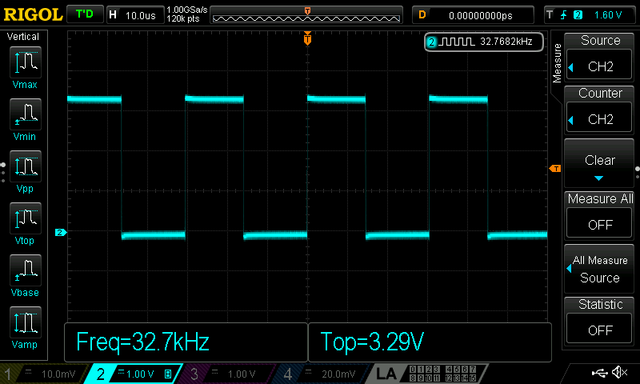

10mhz timebase osc
dendad
Joined Feb 20, 2016
4,641
The output level may not be enough to trigger the 74LS14. It needs to swing above and below the required thresholds. That could be the problem.
dendad
Joined Feb 20, 2016
4,641
I think the signal needs to swing between about 0.8V to 1.8V for the 74LS14 to operate. So, a full 5V swing is not needed.
dendad
Joined Feb 20, 2016
4,641
You could try to have a resistor divider on the input of the 74LA14 to set it to about 1.5V, and then connect the oscillator signal to it via a 10nF capacitor.
Try a 2K2 from input to 0V, and an 8K2 from the input to +5V.
This may (or may not) work.

Don't mess with all that active and passive components. Use MEMS oscillator which gives you reliable perfect rectangle signal with just one IC.
LSE MEMS Oscillator 32.768 kHz, IM890-IDCC-32.768 ILSI:
You could always amplify it with a 74HCU04 with a 10M resistor across it, but you didn't have any 74HC; because if you did, you could have made the ever-so-reliable Pierce oscillator.
