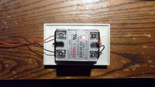

Bottom View showing the SSR:

Let's review the design. The expected load is a pump motor using some 10 to 15 amps when running, more when starting. While isolation was not required an inexpensive 40 amp solid state relay was picked to drive this as a drop in pre-tested good solution. Also, should it fail it is connected by screws to it is field repairable.

A MOSFET is used as a driver to chirp the speaker. Another MOSFET pulls the drive side of the SS relay low to turn it on.
