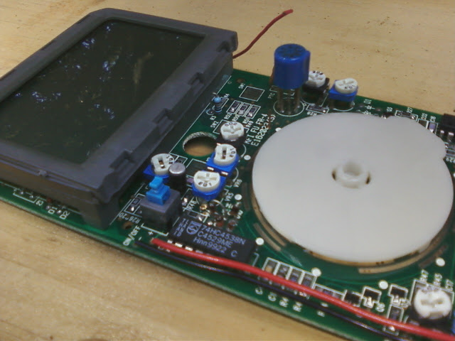

I have this nice older digital multimeter which I may have damaged.
What has stopped working is the k type temperature reading.
It was working but then I accidently had the probes in the ohm position hole and measured 110 ac volts. There is a fuse I bypassed years ago and that ohm meter position is fused at 650ma listed on the front.

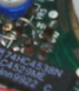

So I took the meter apart and noticed 2 traces have been obliterated on the back of the board. Just had a small length of copper trace remaining. The traces terminate in little copper traced holes and they look fine. Traces to be repaired are about an inch long.
These traces are pretty small. What would be the easiest way to attempt a repair?
I was thinking an extremely tiny insulated wire? Not sure If I have that.

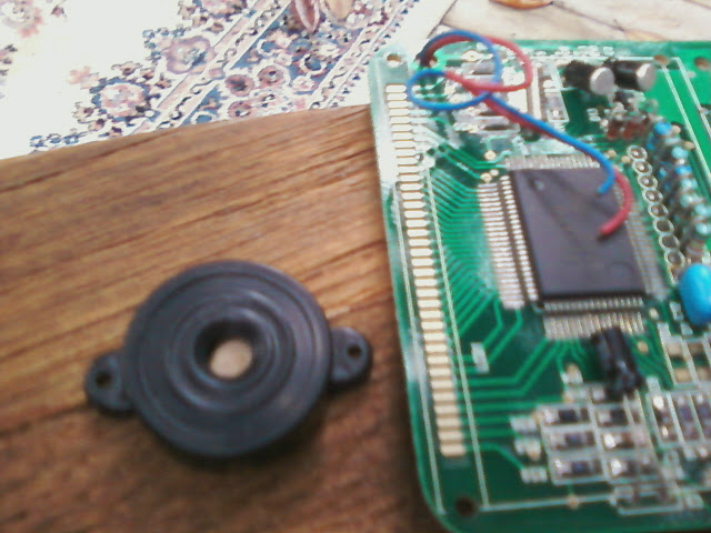

Another issue the beeper sound maker is destroyed?
It was laying inside the meter in 3 pieces, the wires had broken off. It has a flat disc with a couple solder connections. I snapped it back together but the flat disk rattles around inside the black case?
shows 2 burned traces.
black speaker, I have no idea If I should try to hook this back up.

You can fairly easily repair the traces with a small (30AWG, 32AWG) hook up wire. I would use one that is insulated to prevent it from shorting to any exposed pads or vias. Be sure to clean the area real good with isopropyl alcohol and scrap away any of the carbon/burned trace with a sharp x-acto type knife. You should be able to take the wire from via to via and be good.
Double check the traces on the other side of the board to be sure no damage is there as well.
As for the piezo buzzer, that one is probably toast. I think you could get another one of similar size and solder that in, if you really want the buzzer that is.

You can put in insulated jumpers if you have convenient solder pads to connect them, but I tend to run a strand of copper wire over the old trace. Personal preference? What the existing damage will allow? Your choice.
You can try the old piezo noise maker. If it works, fine. If it doesn't, you can get them at Radio Shack.

Winding wire...enamel coated? Sure. That will work. Old resistor leads are too stiff. You can glue it in the middle as long as you solder the ends.
3 volts worth of batteries? How about a 3 volt buzzer?
You're getting ahead of yourself. Find out if the meter survives surgery before you buy a buzzer.

I successfully repaired the traces using some old verizon tiny solid copper wire.
stripped the end and it fit into the tiny holes and then soldered.

I followed one of the burned traces and it connects to a small glass diode.
Diode is exploded.

I just replaced the diode with a 1N4148 from Radio Shack and everything except the temp is now working.
