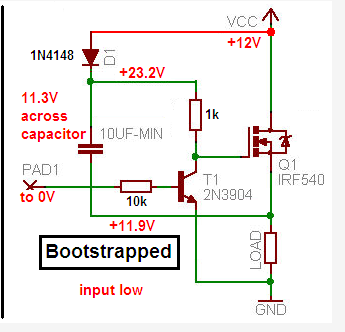

Hello,
I want to make a buck converter for lead acid battery charging. I want to use IRF540 N Channel mosfet. And I don't want to use any driver IC to drive the mosfet gate. I shall send pwm signal from 5v microcontroller. Can I use the following bootstrap circuit (found on net) instead of using any driver IC for my purpose. Or is there any better method to drive the mosfet without a mosfet driver IC? PAD1 of the circuit would be connected to microcontroller's PWM pin.
Thanks in advance.
Best regards.

The answer depends on the frequency of operation. Which is?
At high frequency, supplying and removing the gate charge adds up to a significant current. At "low" frequency, it's too small to matter.

This is out of my range, but I believe the capacitance of the IRF540 is 2nF, or 20nC at 10V. Moving that charge in and out at 500kHz is a current of 10mC/s = 10mA (or is it double that, the sum of in+out?).
That doesn't sound so bad. Maybe inductance increases the problem.
Anyway, we'd better see if someone with more experience can help you here.
It's a little worse than that. ;)
Per the data sheet the IRF540 has a total gate switching charge of 71nC. At 500kHz the switch period is 2μs. Assuming you want a switch rise and fall time of no more than 10% of that or 0.2μs gives a switching current of 71nC/0.2μs = 355mA. That certainly requires a much lower resistor value than the 1kΩ pull-up shown in the schematic. A push-pull or totem-pole type driver would likely be required.

50kHz is about as fast as you'd want to run that. You might could go somewhat faster depending on the value of the inductor that you would use with it.
You're showing +12v for your supply, which won't be adequate for charging a 12v lead-acid battery. You would need ~13.7v just to float-maintain it (standby mode). If you're charging it after being partially drained, you should charge it at a constant current until you hit ~14v to ~14.5v before dropping back to the "float" value.

By reading the replies I am not confident with the circuit. Can I use a NPN transistor like TIP-122 instead of mosfet? Since it does not have special gate voltage requirement like N Channel mosfet.

The frequency can be 100kHz to 500kHz. Which frequency will work best for the circuit?
Why such a high frequency?
You cannot use that circuit to charge a battery without some limiting impedance in series with the battery (resistance or inductance).
