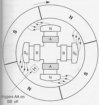

I really wish I had the grapics software and skills to make animations. Picture this:
I'm not sure what A,B,H, or Sc mean in this picture, so I'm ignoring them (and ignore the arrow at the top). Also, keep in mind as I continue, I am describing things as I understand them so that maybe you can pick out where exactly my misunderstanding is; I have no intention to lecture you on how a motor works. This picture shows the force of attraction between the N & S poles, and in the picture is looks as if the rotor is moving counterclockwise, and just about to line up with the permanent magnet poles on the stator. As soon as this happens, the DC will shift to a different set of windings via the brushes/commutator and the poles will shift, again attracting, and a never ending cycle of attract/shift/attract will occur.
Now, using this same picture, imagine you reverse poles on the rotor and the direction of the flux arrows so that the poles are opposing each other and it should spin the opposite direction via oppositional forces rather than attractive forces
...Actually, when I say it that way, all that would be required is to swap polarity of the DC. When you do that, you swap rotation direction, which checks out in real life. now when I look at that picture I see oppositional forces already at work. check it out:
So in the motor N is repelling N at the same time as S is attracting N!
Am I right? I think I'm getting somewhere.

Well, actually that diagram shows the stator as the inside, with the coils, and the moving rotor is outside.
And as I said, the motive force is provided by attraction on the unlike poles, as the magnetic field that produces the most easily harnessed force is the unlike poles N and S attracting each other.
Anyway I'm losing track of what we were supposed to be talking about! ;)
Yes, I couldn't find a good picture of what I was trying to talk about, so I tried to make that picture work. That's why I said to ignore the directional arrow. I found a better picture, read on...
Yes, I agree, but I think I'm also seeing a repulsive force at work. in the picture below (left), the rotor's north pole is at about 1 o'clock. Wouldn't the North pole of the stator's permanent magnet be pushing the rotor's north pole until it got to 3 o'clock, at which point the rotor's south pole would take over by attracting it? Wouldn't that mean that during operation the permanent magnets are held in opposition for 50% of the time?
I'm still just trying to figure out why the magnets in a permanent magenet motor do not deplete. I think now that when held in opposition, the magnet is drained, and when held in attraction it is charged. if this is true and it is also true that it is held in opposition for 50% of the cycle as I propose, then there is a balance between the attractive and repulsive forces which means it would never deplete, except for environmental causes (banging, heat, etc.). Does this all sound like poppycock?
