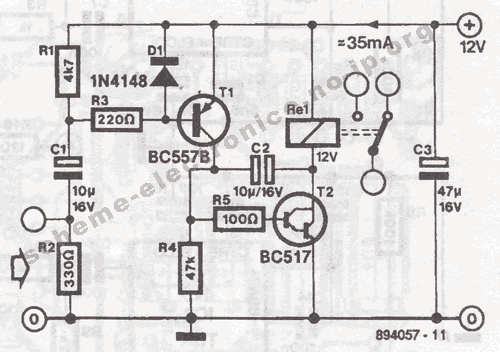

Hello,
You could try a VOX circuit like in the link:
http://electroschematics.com/354/vox-circuit-schematic/
Greetings,
Bertus
A couple of questions: does this circuit really need +12V? Is there a way to do this with 1.5V / 3V? Could I use 2N2907 (or 2N3906) instead of BC557B and two 2N3904's (or two 2N2222's) instead of BC517 Darlington pair?
P.S. Is my circuit complete unusable? No way to fix it?

Hey guys, so, I assembled a circuit like this (thanks, bertus):
As a PNP transistor though, I used 2N3907, for Darlington pair I used two 2N3904's, instead of 1N4148 diode I used 1N4001, instead of 47uF bipolar I used two 22uF's in parallel (is any of this essential? I'm not sure I can get other transistors but 4148's I could probably find).
The relay is nexxtech 5-amp relay (12V DC, 60mA, 200 ohm), it switches on/off at ~6.7V.
The incoming audio signal peaks at 0.5-0.6V or less. I'm not sure I measured that right, my voltmeter is not precise on AC.. the audio signal is slightly amplified by the walkie-talkie though and it's significantly louder than your iPod line out.
The way this circuit currently works is somewhy very unpredictable.. it works, then it doesn't, then a relay turns into a loudspeaker, then in 'off' state the voltage drop increases twice, then it works fine again, then it just stops working. I tested all connections and wiring twice - it's pretty solid.
This circuit is supposed to be powered by 12V DC (in the schematic), however if I give it ~12V via universal adapter, the relay tension is too high even when there's no audio signal. When connected to universal adapter at 9V (somewhy I had to set it to 6V to get 9.10V lead to lead on my voltmeter), this circuit catches the audio peaks (about 8.2V on relay) and very often it starts switching on and off rapidly. Sometimes it keeps locked on, even when the audio signal is very low. Sometimes the relay starts working as a mini loudspeaker (?) - buzzing and reproducing the incoming signal with distortion. Btw should I protect the circuit against relay spike?
When I connected the circuit to 12V battery (a small A23), it started draining it pretty fast and acted weirdly; when I connected it to 9V battery - sometimes it would give just 3 volts on relay when there is audio signal, sometimes it would only switch on during the loudest audio peaks. If the relay 'catches' the audio peaks correctly, then one way of fixing all this is somehow lowering relay's switch-off threshold? Or kind of latching the 'on' status for a couple of seconds?
Any help/advice?
