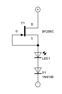

Well, that was easy, around 7:00PM tonight, 10/31/09, it dimmed dramatically. No gradual fade out here, though it is still flashing dimly. I like it when an experiment is so neat and clean like this. I'm debating whether to modify it with a simple constant current source and use a red LED, for maximimum life. Whatcha think?

Hello Bill,
The current source will also take some current for itself.
This will shorten battery life a bit.
You could try a fet as current source, this will only drop some voltage.
The current will be depandend on the type of fet used.
Greetings,
Bertus

I'm aware of the fet variaty, but you can't program them (I think). I've got another design that will work, not a totally flat current curve, but it will work. When I get a chance I'll put it up.

The thing I don't like about that approach is several, you don't get the same value with different parts, and the part have to be easily available (Radio Shack again). They have an experiment where this is done in the book, which I thought was cool.
The approach I was thinking of doing was something like this...
