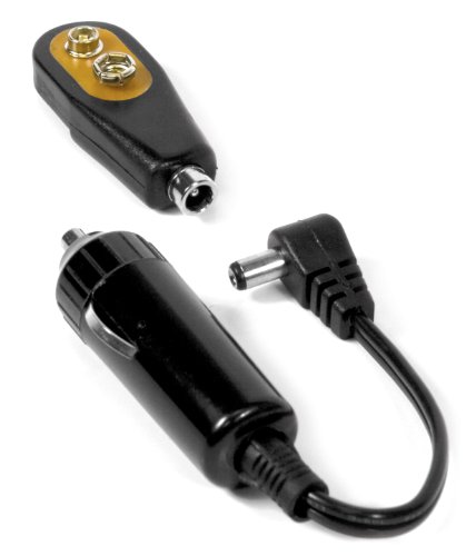

I use a external keep-alive battery when replacing the battery in modern cars. A simple diode isolated 9V battery into a power port works for short periods.
