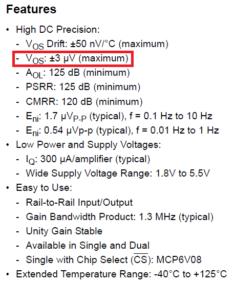

What is the specified maximum input offset voltage of your opamp?

I think your negative reading may be due to thermocouple cold junction effects.
Consider this:
You have one hot junction AB (within the soldering iron tip), consisting of two different metals A,B, neither of which is copper. Your connections to the soldering iron are via copper wire C (and also via meter probes which probably have plated tips of yet another metal). So you have at least two thermocouple cold junctions AC, BC. If the temperatures of the AC and BC (and any other) junctions differ then an unwanted voltage is added to the wanted thermocouple voltage. The voltage you measure is the sum of all the voltages produced because of the various junctions.
You can add a small positive offset voltage to make your readings positive.
