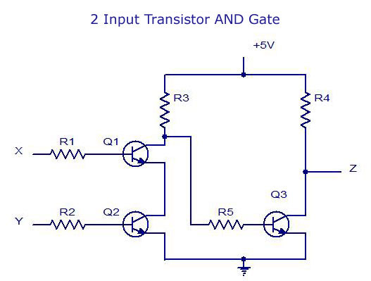

Hey, thanks for the replies! What you guys are saying makes sense, but how is {Q5, Q6, R6, R8, R9, output} any different from an AND gate?

What I'm saying is this looks exactly like what I have on the right where my circuit isn't working correctly.
That will sort of work as an AND gate if the value of R is much larger than 1kΩ. That will minimize the feedthrough voltage with A is low and B is high.
The upper limit on R is determined by the current gain of the transistor.

Here's a better version:
Oh wow that actually works perfectly, thanks. One thing I noticed with my circuit was that the voltage dropped to about 3.3V after going through the gate. Why does the same thing not happen with this AND gate?
Because there are no base-emitter voltage drops in the output path.
The output is a common-emitter transistor that is either fully-on saturated (output within a few mV of ground) or full-off (output pulled to the supply voltage by R4).
