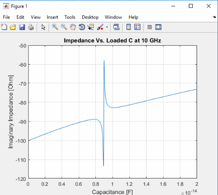

I am trying to come up with an equivalent circuit for a structure that I'm working on. The response is shown below:
The modelling of the structure hasn't incorporated any loss, therefore the real part of the impedance is 0. I am not a circuit expert, and would like some pointers on what kind of circuits would be capable in producing a response like this.
I was pointed to this circuit:
However, it generates a different response as shown below:
Where the imaginary impedance first increases near resonance, then decreases.
I tried a few simple LC circuit configurations but wasn't able to find one that matches my expectation, I was wondering if anyone could give me some pointers.
Thanks!

Here's the LTspice simulation of an arbitrary series, ideal LC circuit.
I drove it with a current source (1Aac) so V(in) is a measure of the circuit impedance.
As you can see, below resonance, the impedance steadily drops until going to a very low value at resonance, and then steadily rises above resonance.

But the *impedance* response that I am expecting is
Y axis is impedance, not current.
