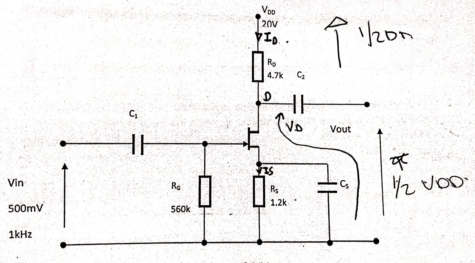

What is the configuration of this FET?
rq89
Joined Mar 11, 2015
9
Can anyone please tell me what the configuration of this FET is and perhaps explain why.
Thanks in advance.
WBahn
Joined Mar 31, 2012
33,310
All of the capacitors are probably chosen so that, at the signal frequencies of interest, they look like short circuits. So consider the names of the three basic amplifier configurations and see if that gives you an idea.
crutschow
Joined Mar 14, 2008
38,912
The configuration is common source but I'm not sure how this differs from common drain/gate
A common-drain (source-follower) circuit has a high input impedance, a voltage gain of slightly less than 1, no signal inversion, and a low output impedance.
A common-gate circuit (signal applied to source) has a low input impedance, a current-gain of 1, and no signal inversion.
