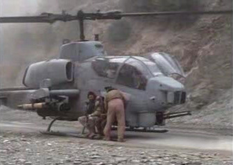

I spent two tours on WestPac on a Helo carrier and flew in everything but the Cobra gunship.

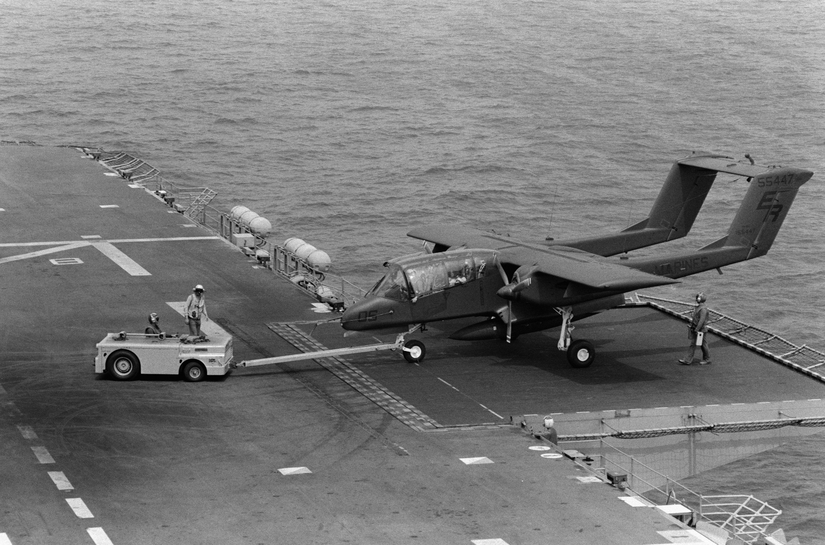

Due to my job I traveled a lot in the fleet on just about every aircraft from a C5, to carrier CODs, to an OV10 bronco,
For some reason that didn't scare me but it should have.
