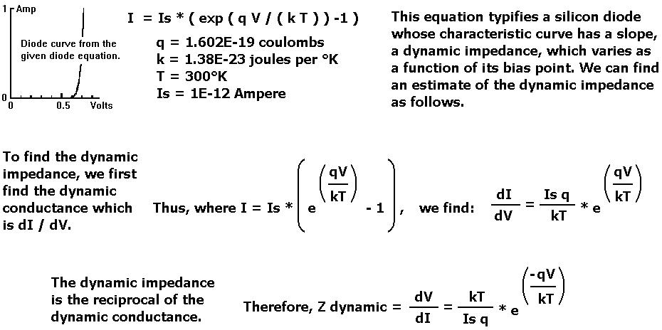

Keep in mind when you use the diodes your output Z goes form
being ~ = a voltage source to much higher impedance, basically
the dynamic diode resistance.
Regards, Dana.
But that's the open loop impedance.
The closed-loop impedance is approximately the diode impedance divided by the open-loop gain, making it very small.

@crutschow
The sim shows, at 1 Khz, a node Z of ~ 12K. I thought you were correct once I read your
post, that (2 X Zdiode) / AOL, but then I kept thinking I am looking into a 10K in parallel
with diode dynamic R. But that would have produced < 10K, whereas the sim shows the Z
up, at 1 Khz. I confimed at 1Hz same result.
This is junction of diode and 10K and Inv input.
Top trace is current into R1, you can't see it because its blue.
I can't explain this.
Regards, Dana.
