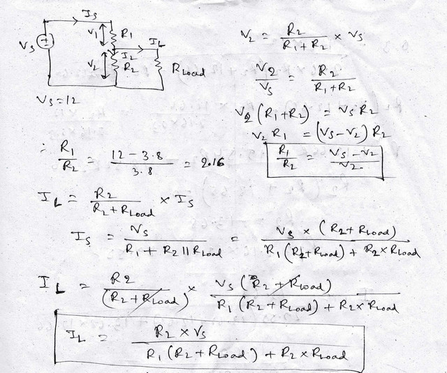

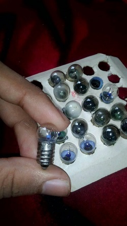

Hello guys I have some bulbs like this.
Which takes about 3.8v,0.3A current. Now i wanted to drive 21 bulbs in parallel.But i have only 12v volatge source.So i decided to use a voltage divider . when i calculate the resistor value required for voltage divider i get the following result.

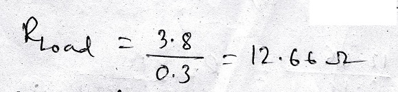

Since each bulb takes 0.3A current and voltage across each bulb is 3.8V.

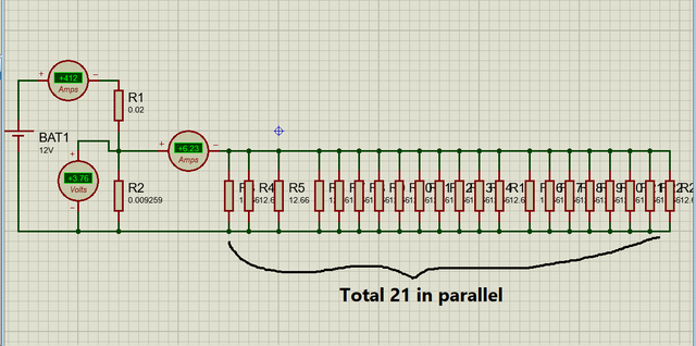

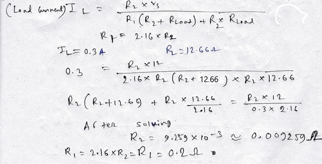

But when i simulate it in proteus i have seen that increasing the load causes decreasing the output voltage across the resistor R[sub]2[/sub].i.e, the output voltage drops from 3.8V to 3.76V.But my requirement is 3.8V. My question is there anything wrong in my equation or solving method??

Three of those bulbs in series would need 11.4V and a diode or resistor in series with them would drop the remaining 0.6V without wasting much power.
Repeat that 7 times and that makes 21 bulbs then the final bulb with a suitable series resistor for the last one.

All of the calculations under the sun wont let you drive a variable load with a voltage divider. (not with a constant voltage anyway)
Use a regulator instead.

Each bulb has a value 12.67 Ohm @ (3.8V * 0.3A) = 1.14 Watt.
