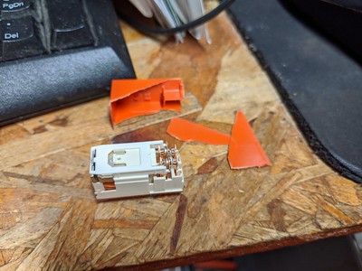

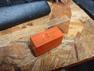

MaxHeadRoom Joined Jul 18, 2013 30,869 Sep 5, 2020 #22 The only thing to open on that relay is the wash down 'Pip' It pays to snip off the vent plug, it is there for de-fluxing normally, unless used in a harsh environment. Max.

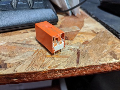

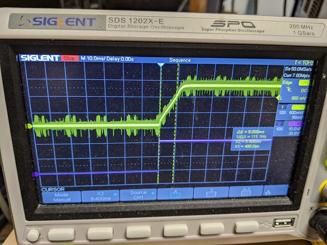

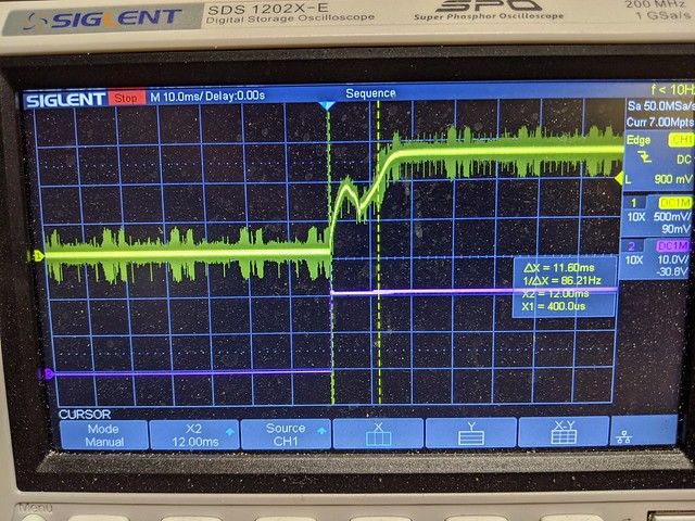

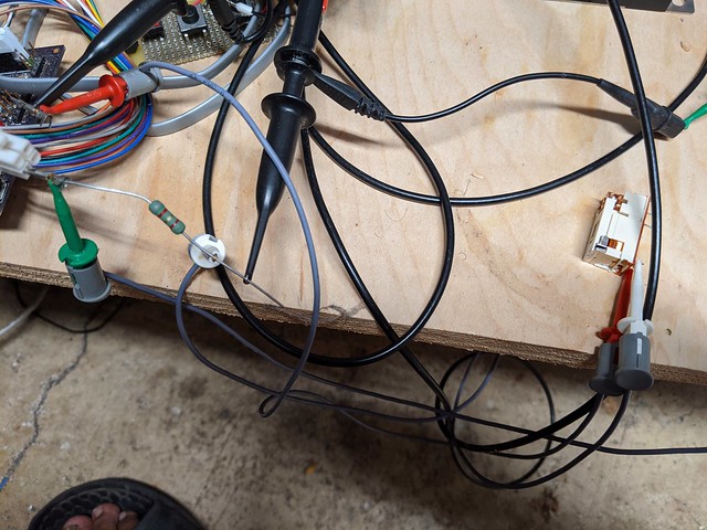

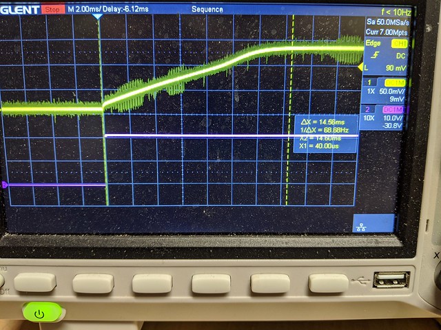

nsaspook Joined Aug 27, 2009 16,503 Sep 5, 2020 #23 The 24vdc Schrack relays I have in the junk box are easy to open. Cut the thin plastic off the contact side. 8.2 ohm current sense resistor Yellow trace is actually 1X Relay free and closing during voltage application. Relay held closed during voltage application. Last edited: Sep 5, 2020
