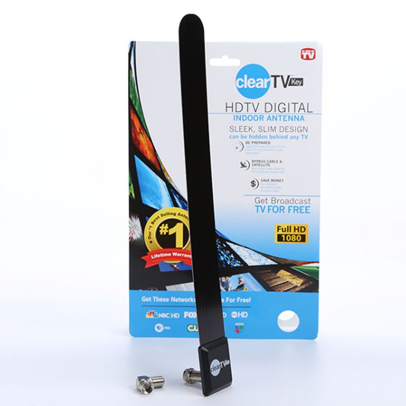

Thanks, guys. The ones in post #11 are the ones seemed to have better performance and sales.
But that was not the point... What is inside these not-amplified 'rods' ? ----> https://www.dhresource.com/0x0/f2/albu/g5/M00/AC/B3/rBVaI1i445WAO6VnAAPn4ZSWXBc521.jpg
It's just an aerial. It may have a loading coil to match it to the TV input. Some indoor aerials also have an amplifier but then they a power supply too.
Yes, an aerial. Can you explain 'loading' coil ? Loads what ? To match what ? At what frequency ?

About 25 cents worth of plated metal on plastic most likely. Fixed length 'rod' antenna.
It probably has a 300-75 ohm balun at the base. The intrinsic impedance of a rabbit ear antenna is 300Ω. The input impedance of all new TVs is 75Ω, so for a proper match, the balun is needed. A good balun will work across the entire TV frequency band.

A balun at the base and essentially some copper tape in a specific pattern on a flexible base laminate encapsulated in plastic..
