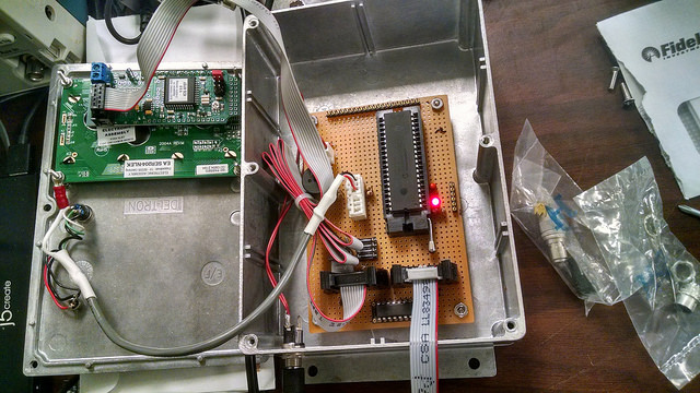

A fairly simple serial command response controller using the PIC18F45k80, max232 RS-232 converter and mainly leftover previous project parts for a automatic digital servo amplifier programmer.
https://github.com/nsaspook/mphase/blob/master/srhmi_e.pdf
The software is programmed in XC8 2.0 with MCC 3.66 for the boilerplate module configuration templates. Version 2.0 has C99 compatibility so you can use non-constant initializers in structures and/or designated initializers with a few other added goodies over old C90 ANSI C.

Simple one-sided solder pad board with 28awg direct wiring between components.
The box eliminated the need for a laptop with serial port and terminal program for the zero procedure.
Still need to add the serial port connector to the box instead of a ribbon cable. :(
Complete software and most of the doc's used. Still needs some error checking work.
