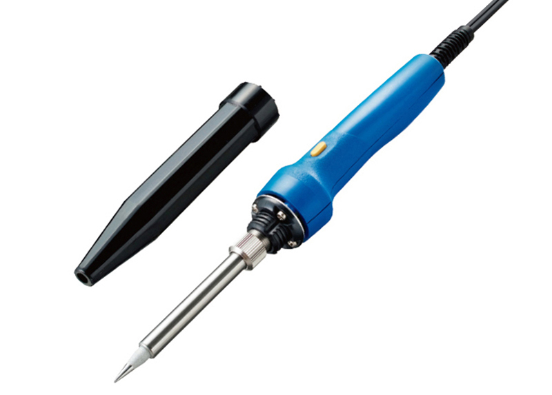

I have been using this for 1.5 years . nice one indeed . goot tq-95
I'm looking for a temperature controlled iron.
