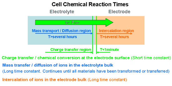

I have an old C40 PWM charge controller connected to a several hundred watt solar array. No filters on the PWM output and it's been charging lead-acid batteries for at least a decade. Battery charging is a diffusion process that's mechanically slow when compared the the PWM duty cycle so at reasonable source peak currents for the size of battery (it is possible to pump electrical energy into the battery faster than the chemical process can react to it, this is bad :rolleyes:) it will average the energy for the duration of the pwm cycle.

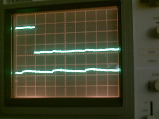

A old scope trace (bottom) of battery charge current pulses during C40 PWM voltage set-point control.
A old scope trace of battery charge current pulses during C40 PWM voltage set-point control.

At last a definite answer to my enquiry regarding direct connection to a battery of the pwm output of a pwm charge controller. Thank you very much nsaspook.

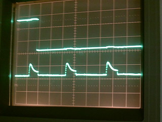

A really old scope display of panel voltage and battery current on the C40.
Battery charge current top, input panel voltage before charge controller bottom
Battery ripple voltage bottom trace.
