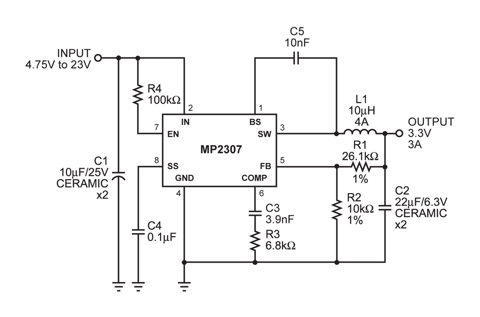

I started to use MP2307 for an application :

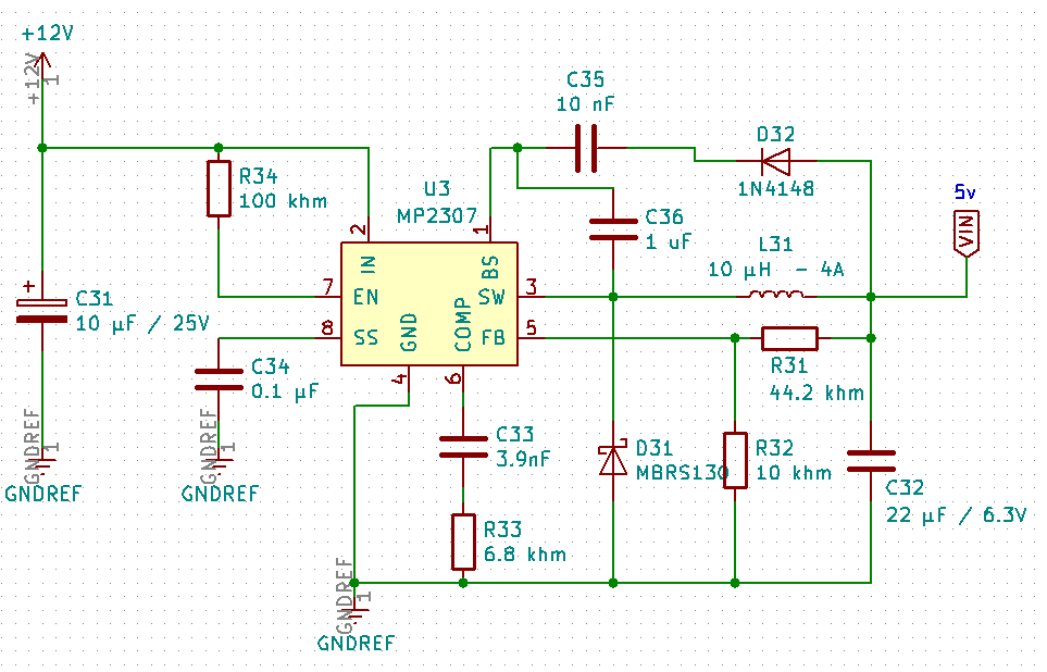

Then with reading the datasheet i finally draw this on Kicad :
Compared to original schematic, i added D32 and C36 for better 5v output, then adjusted R31 & R32 to get correct 5v output. By what was said in MP2307 datasheet.
When i started up the application, it worked well, but under heavy load (~2 amp) it started smoking around L31 - C36 - D32
Suprisingly, it's still working and doing the 12v -> 5v job after that event.
Here's the BOM :
L31 - Inductor 10 µH / 4A - IHLP2525CZER100M8A
D31 - B130 - MBRS130LT3G
D32 - 1N4148 - 1N4148W-7-F
C31 & C32 capacitors are tantalum.
It is actually my first board, What could be wrong ?
Thanks a lot !
