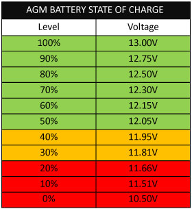

After 9 days of camping at 50% Depth of Discharge = only 4 hours of run-time per day ...
You will permanently reduce your car battery's capacity and will shorten the battery life by, at least 5 1/2 months.
After 9 days of camping at 100% Depth of Discharge = only 8 hours of run-time per day ...
You will severely damage your car battery and the battery will need replaced before the first cold day in the fall.
Now, how do you restart your car in the morning? A Jump?
The voltages listed in the ( AGM ? ) Battery State-Of-Charge chart are ...
"The Voltage after resting the battery no-load for 12 hours", not the battery voltage when Under-Load.

Actually, a Starter Battery can be Deep Discharged, ( you can do anything you want ) but you will pay a huge price, maybe even destroy the battery.
Portable Power ...
a) An SLA-AGM Deep Cycle Battery = cheapest per watt, but heavy
b) Lithium Battery / Jump Start = expensive per watt, but lightweight
c) Super Capacitor
d) 50 watt Solar Panel Charger + Small Battery pack for clouds
e) A small Inverter-Type "quiet" Gasoline Generator
use anything except your car's starting battery.
