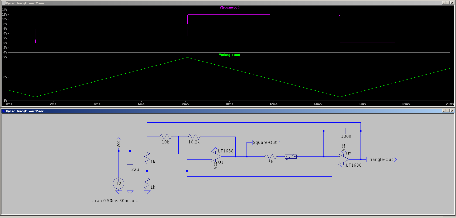

For minimum parts count, below is a linear sawtooth generator using a dual rail-rail op amp as a comparator and an integrator, whose output goes close to 0V and the supply rail.
Pot U3 controls the frequency.
(It's basically one of the circuits in Bertus's post # 10 reference).

Which are the resistors which change the rising and falling edges of the output wave in the opamp only generator?
Pot U3 and C1 determine the U1 integrator time-constant and thus the triangle-wave rise and fall time, along with the frequency.

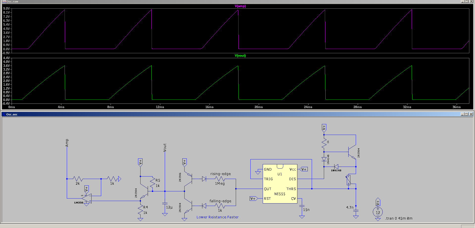

Does this oscillator need a rail to rail opamp to remove offset?
I dunno.
Is the offset shown in the simulation tolerable for your application?
What's wrong with using rail-rail op amps?
First you show a triangle-wave oscillator and now you show a sawtooth-wave oscillator.
Which do you want?
(Or don't you care which it is)?

Thats design is inefficient. Wasting too much current on threshold voltage references. Anyway a simple emitter follower will removes the offset down to .~250mv

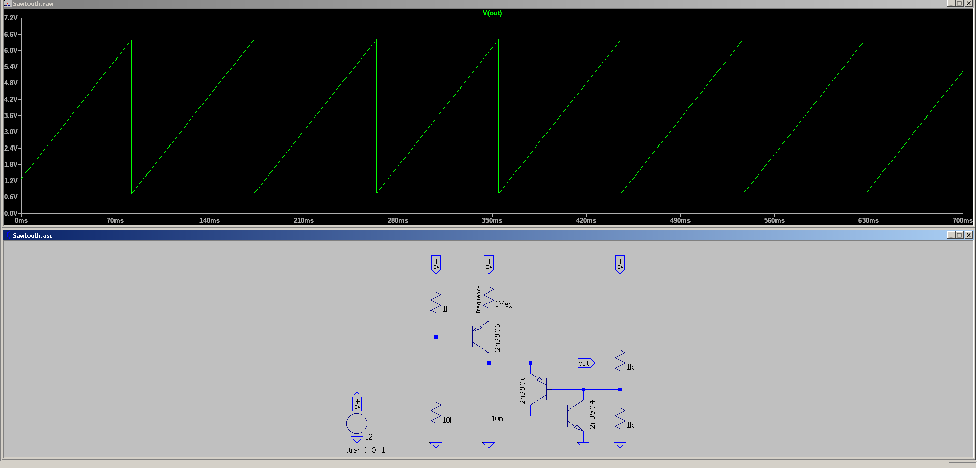

The circuit works best with a sawtooth which charges an large inductance to prevent damage to it by charging it slowly. Theres nothing wrong with rail to rail opamps the other circuits posted here are useful.
