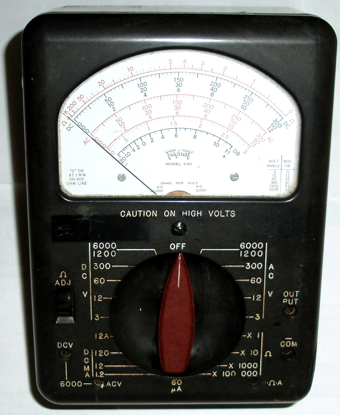

I was able to dig out a lot of old analog test equipment last night. And I'm still struggling to read the analog scales. And these analog meter scales are not all exactly the same between meters. The one standard is that they do all have Decibels on the bottom. Why did we ever have to measure Decibels?
Anyways, k ohms are at the top; 2 k, 1 k, 500, 200, 100, 50, 30, 20, 10, 5, 0. < -- (a scale printed in red ink)
Then : DC /AC: The Three black scales:
0, 10, 20, 30, 40, 50, 60. < - - micro-amp/volt scale ?
0, 5, 10, 15, 20, 25, 30. < - - milli- amp/volt scale ?
0, 2, 4, 6, 8, 10, 12. < - - regular-amp/volt scale ?
- I set the dial high to as to be safe about pinning the needle to hard. (300mA) was the highest option.
- And the needle went 2 notches just shy of going all the way to the right.
- Which scale are we looking at? (I did not zero the ohm meter cause I'm not taking ohm readings)

Can you post a picture of your meter? I might be a little rusty but lucky for you I was brought up on an analog meter as my brother was an electrician and electronics fanatic back in the day, so it will take a few seconds to register, but I can help you out. Also, which test are you using it for? I am hoping parasitic draw because it will not be large enough for doing the 3-minute charge test.
You will notice that the dB scale is typically rated at 600 ohm impedance ... 0 dB = 1 mW @ 600 ohms = 0.775 V.
I used it all the time in broadcasting when I was in high school working at a radio station (early 1970s)
The AC scale is usually different. You can pick the DC scale depending on range.
These meters used a 1.5 V battery for the ohms function. You shorted the leads and used the "ohm-adj" to make the meter read zero.
These analog meters were rated in "ohms/volt". So a 50K ohms/volt meter would present a 100K load on the circuit when measuring 2V. Digital meterst ypically have a constant load of 10 meg ohms independent of the voltage read.
