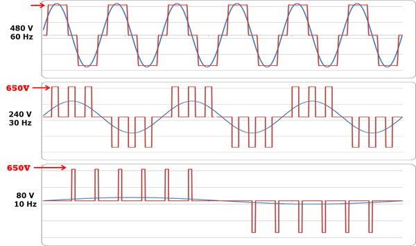

Somehow I feel instinctively that detecting voltage level for on/off switching is more straight-forward.
It isn't as straight-forward as you'd like it to be. Firstly, the mains wafeform amplitude is subject to change due to varying load. Secondly, the waveform is far from a pure sine wave and has all sorts of spurious noise superimposed on it.

Mostly it just comes down to setting up a comparator to look at the AC wave formone half at a time and using that to determine when to turn the switching device on and off.

Because there is not always one answer to our questions. Without knowing the "justification", it may not be possible to identify which answers apply. Otherwise, simply reverse engineer a household dimmer. I too am interested in this question, so that I may control AC from a micro. So let's not let this get personal.
The dimmer "solution" has been out there a long time. It gives erratic pulse spikes that start abruptly and trail off and is crude to say the least. It's not PWM, at all. I don't understand the need to justify something that's not illegal.

Sorry for missing that, OK I see the Control Circuit A (which seems the only one relevant to what I need); I think I understand how the time delay voltage detection after zero-crossing detection might work, but does it turn off at the same point on the wave's downside? I wouldn't expect that, though that is what I want, a symmetrical pulse, narrower or wider on both sides of the peak, like my original sketch shows. And only at line frequency, doesn't need to cover a wide frequency band.

Yes it shuts off at the same point on the back side of the waveform.
The comparator is just looking at the voltage of the incoming waveform and switching between a high output state and a low output state when the waveforms voltage goes above or below its reference voltage.
