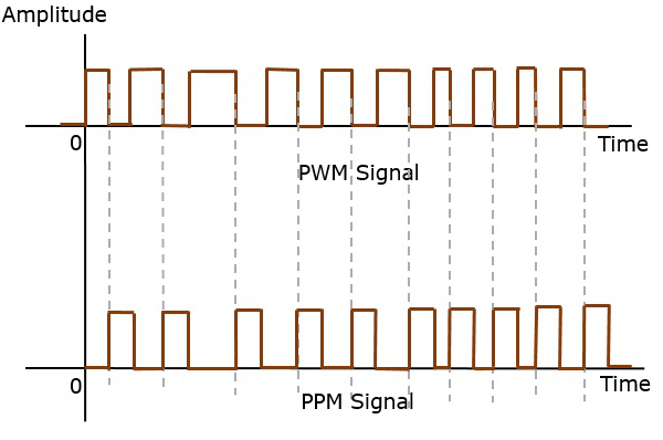

MrChips
Joined Oct 2, 2009
35,094
Got it --- Pulse-width modulation (PWM) is used for controlling the amplitude of digital signals in order to control devices and applications requiring power or electricity. It works as a method for generating an analog signal using a digital source.
Not amplitude of digital signal.
PWM controls the duty cycle (ratio of pulse width over pulse period).
PPM is a variation of PWM:
